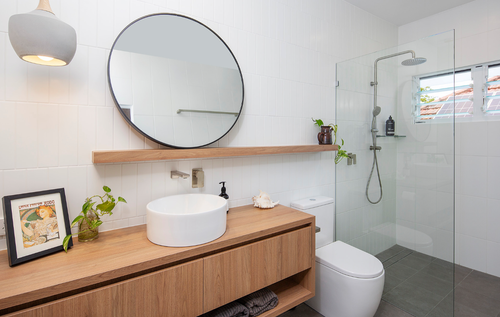

Hey @lotus
Depending on the style you are going for, I'd say a nice grey tile (light or dark), would contrast the white tiles on the wall. You could also use the same tile up one of the walls to create a feature wall that continues the angle from the floor.
I just realised I haven't taken final shots of my bathroom. But this is what it ended up looking like (photos are dark because the lights weren't installed and the bathroom doesn't have a window! Also missing the show door in these photos)
It has come out a treat. We wanted to go for a "moody" look to make it more relaxing. So we have a cool white light above the shower and the mirror for when we need it to be bright, and a pendant which is warm white low wattage for when we want it to feel more moody. This is also useful when you need the toilet in the middle of the night or an early morning shower and don't want to blind yourself with the bright lights ![]()

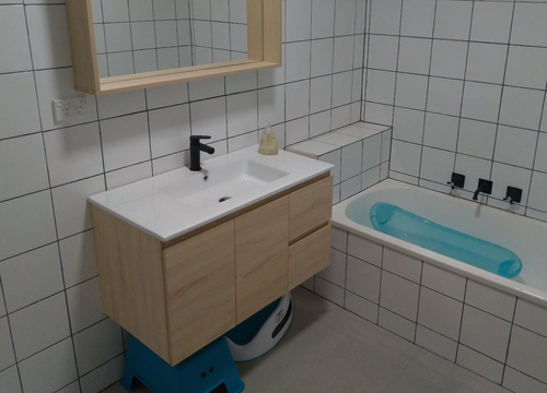

This is our other bathroom with white tiles, and a light grey floor, and dark grey grout to accent the tiles.

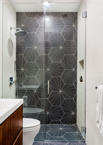

Here's an example off the internet with a grey contrast floor:
Here's an example of continuing the floor pattern up the wall (though I'm not a super fan of the particular pattern

Thanks Itai, i am liking the second last one with the grey floor continuing to the wall up.
tried to link that image but somehow it didn't get attached due to format,,
I think it will look great with the handmade gloss white that i picked for rest of the wall....
