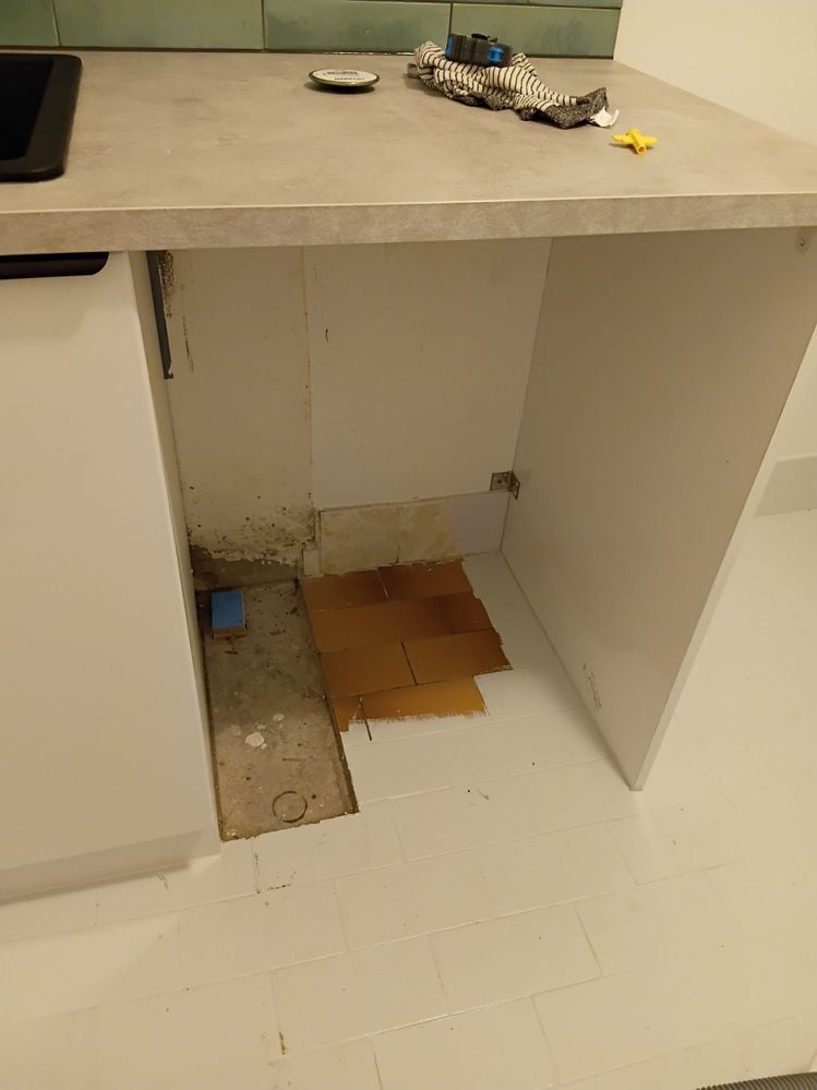

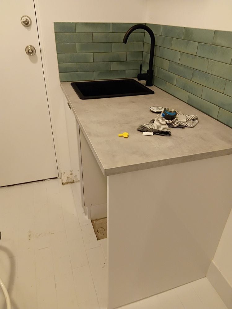

I've made some good progress on my laundry reno but have hit a large and very frustrating hurdle.
Basically the cabinet installer has not done his measurements correctly (despite the washing machine being in the same room as him at the time of install), and has installed the brand new benchtop too low for the washing machine to fit in.
My washing machine is 85 cm tall, and at the back of the cabinet the height is just under 84 cm. As the floor slopes towards the drain, the height at the front is just under 85.
The floor where the washing machine will go already has a hole in it, which is where the old cabinet went.
I just did the tiling back and sealant on the benchtop myself, and the sink has been installed so raising the benchtop isn't an option anymore.
The washing machine has already been lowered as much as possible and I thought about taking off the top but I really don't want to do that with all the wiring exposed.
So I figured the only option is to cut out the tiles - the question is how? Some of the tiles are split on either side of the base panel - is there a way to cut them?
And any recommendations on how to level up the floor once it's lowered so the washing machine can kind of slide in?
Thanks so much!
Louise

I would bite the bullet and raise your benchtop 20mm (well 19mm) with some pine dar on top of the cabinet between it and the bench top.
42 x 19mm 1.8m DAR Pine Premium - 1.8m
There will be some screws from either brackets underneath the benchtop or straight through some timber flats to remove.
Your sealant you will have to remove and redo.
The benchtop I would "cheat:" and bring it forward the thickness of the tiles so it will still have a tile backing. (And yeah I get the frustration of the odd height tiles may bring 😕 )
The Gooseneck under the sink may need an extendingpiece fitted but they are available from Bunnings.

I wouldn't cut the tiles, I'd bring the bench out from under them and raise it in front of them. That will leave you with a slight overhang from the tiles on the right and a tile thickness proud of them on the front. You'll then just need to deal with the gap between the bench and the cabinet, as well as the side panel, which was going to happen either way.

The idea @MitchellMc had to unfix the benchtop and pull it out just enough to clear the tiles is an excellent one. But you still have to deal with raising the benchtop. Thats not going to be too difficult, but you will need to disconnect and remove the trough and tap fitting. @Dave-1 has given some great steps on how to do this.
You probably should allow to increase the bench around 15-20mm due to needing that machine feet adjustment wiggle-room. Something like this 18mm square DAR pine flush to any exposed edges would be ideal to sit on the 16mm cabinetry. There is a 12mm square option if thats too big. I would just use a good wood glue for this and brad nail it down in a few spots to secure it in place. You could either use a satin white paint to the exposed sides of the DAR pine or fix a thin strip of white aluminium flat bar.
Ok, for another possible solution and one I have had to do before because raising the benchtop wasn't an option, was to lower the floor just in the cavity. I removed the tiles and cement underlay level with the front of the cabinet. I then sanded the area smooth after checking the levels. I applied a couple of coats of a good clear oil to seal the timber floor. Then I set the rear feet at their almost lowest point, which allowed me to simply push the machine in slowly as the rear feet dropped down about 15mm. Then continued to push it all the way in until the front feet dropped in. I check the machine was stable and had to tweak one of the front feet. Turned the machine on with clothes in it and a high spin speed to check stability and all was good . . phew!
