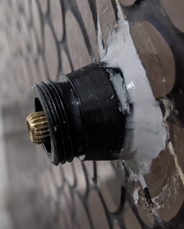

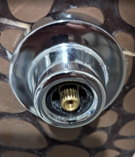

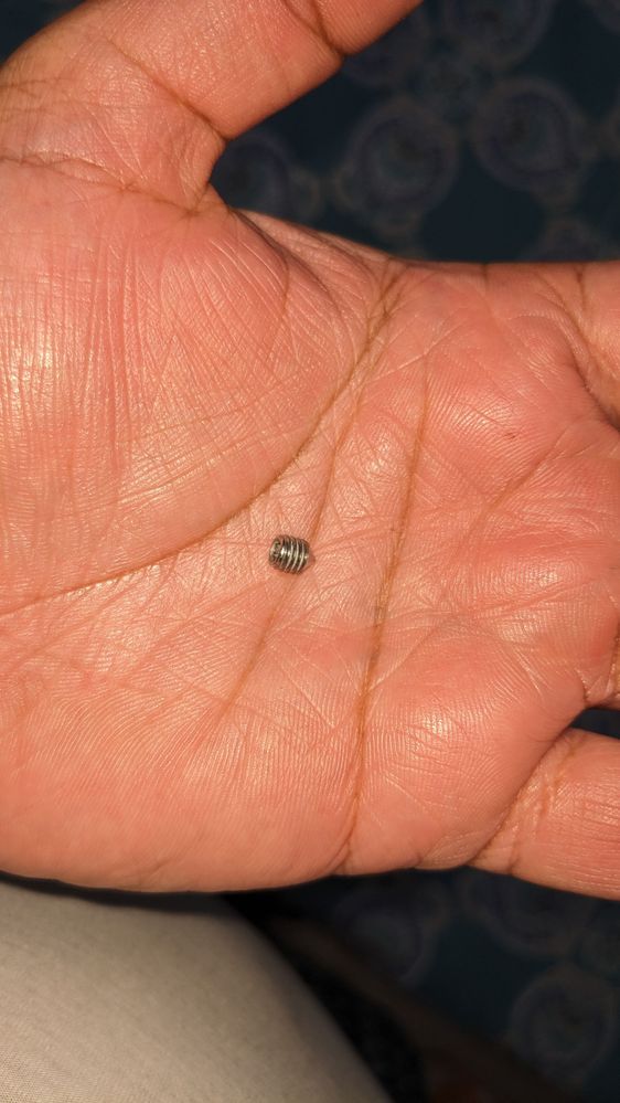

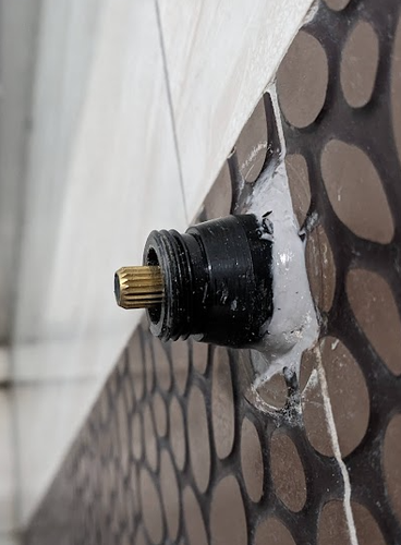

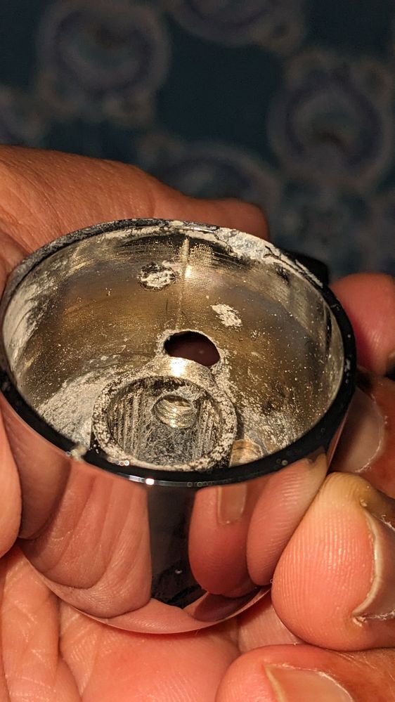

My showers cold handle fell off the other day (doesn't have a mixer tap). I popped it back on and tightened the grub screw, but the grub screw would keep going through the hole. I unscrewed the hot side's handle and noticed the plastic spleen on the spindle (only hoping I got the names correct) was pulled out a bit. So thats what I did on the cold side. Thankfully the grub screw now bites into the plastic cover of the spindle. But now it turns around without catching on to the underlying spindle. I am thinking I either need a new plastic cover or a longer grub screw. Bunnings website doesn't seem to have these plastic covers. Any ideas on how I could get the cold handle back on? A few photos:
The plastic spleen in questionThe plastic spleen in questionGrub screwGrub screwInside of the shower handleInside of the shower handle

Just trying to work out exactly what part is broken in your setup. So, it sounds like the grub screw is now biting into the plastic insert properly, which is good — but the issue is that the plastic insert itself isn't properly gripping onto the internal spindle. Do I have that right?
If so, it sounds like the plastic insert is the culprit here. Unfortunately, you're unlikely to find that plastic piece sold separately unless it's directly from the manufacturer of the tap set. They're generally a proprietary part, not something that’s sold off the shelf at Bunnings.
That leaves us with trying to get the insert to grip the spindle better. Have you had a chance to pull the plastic insert off and check if the inside is chewed up? If it is, and replacing it isn't an option, one not-so-great solution could be to apply a little silicone or even construction adhesive inside the insert before reinstalling it. It might give enough grip for it to work. The downside is that it'll make it pretty hard to remove later if you need to get back in to service the washers.

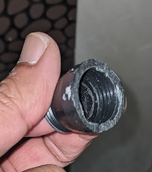

This is the inside of the plastic and the spindle if it helps:
I have now pulled the plastic spleen a bit further out and tightened the grub screw. As a result, when I turn the tap clockwise to open, it just randomly engages with the spindle and turns on the water. Same thing for turning the taps off.

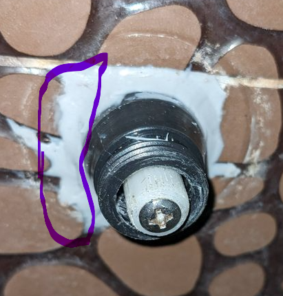

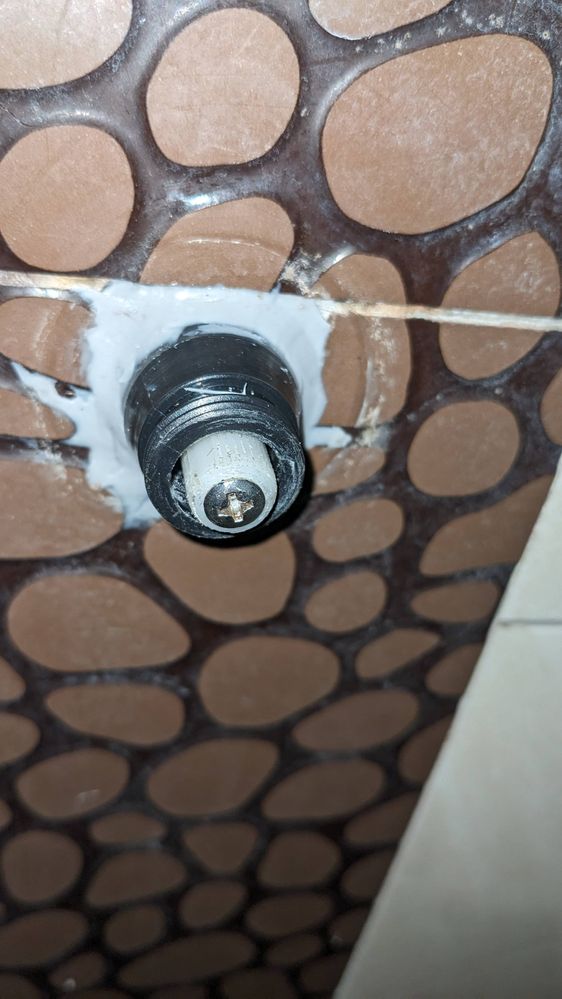

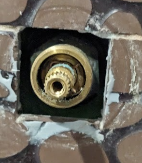

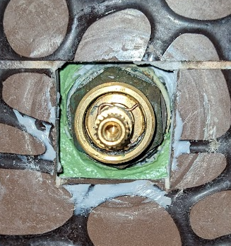

Thanks for that Eric. I am only able to look at this when I can, hence the gap in replying. So, I think I know what the problem is. I opened the hot waters tap, because it works perfectly, and see the spindle is a bit further out than the cold tap. Which is why the grub screw isn't pushing/latching on to the plastic spleen around the spindle teeth.
Hot:                                                                                Cold
Then I took the silicone out to unscrew the bonnet extender. First thought was to replace the extender. But then I saw the extender itself was sawed out. Cold taps extender:
Then I tried to reduce the bonnet extender further and shaved a hair off of the extender, about one thread. Then I realised the real problem. The bonnet that sits on to this extender doesn't even thread on if the extender sits further ingressed to the wall. So, I think, who ever set this up actually sawed the bonnet extender, screwed the bonnet on to this extender, and siliconed it on to the spindle body, without ever screwing it on - end result, the tap bonnet sits flush with the wall, but that conceals the part of the spindle that the tap and grub screw latch on to. I think the solution is to get a spindle extender - just to get the spindle out by a mill or 2. Looking at existing threads that discuss this, it seems like whole another mountain to climb. But happy to do so if I am on the right track and if someone could lay out the steps for me?
Also noticed there is very little room for a tube spanner to unscrew the assembly out. Tried to do it with a shifter and the point end wont even go it. If I end up replacing, how do I unscrew this thing?

This issue with spindle extenders are they typically bring the spindle out a significant distance, not just a few millimetres @Burnings.
To remove the spindles, you'd probably have to give a tap spanner a go, but even that might be a bit tight.

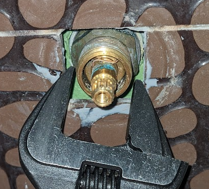

I ended up calling a plumber and thought will post what was done. So this was where I was at. I bought a tap spanner set recommended here - as expected the spanner wouldn't even fit through the tight space. When the plumber came over, he got his multi grip and unscrewed 1 first and then 2.
I had already purchased another tap set (and a bonnet extender and a spindle extender) https://www.bunnings.com.au/mondella-maestro-brass-wall-top-assembly-lever-handle_p5004215?store=818... - it was an easy enough installation and simply screwing in the new set was required.
I was just one step away from getting this done myself and felt so embarrassed that I thought a metallic tap wouldn't take the pressure of a multi grip - and then to further think even if I got the tap out, how would I screw the new one in - the plumber just did the above steps in a reverse order. Lesson learnt - tap bodies can take the pressure of a multi grip. And of course in my case the breach will always have one side protruding out more than the other - still wonder how the previous occupants didn't face this problem with the original tap.
