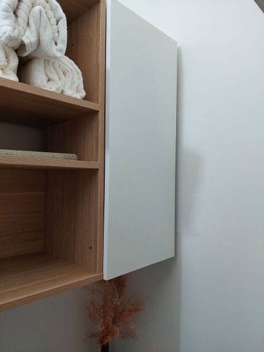

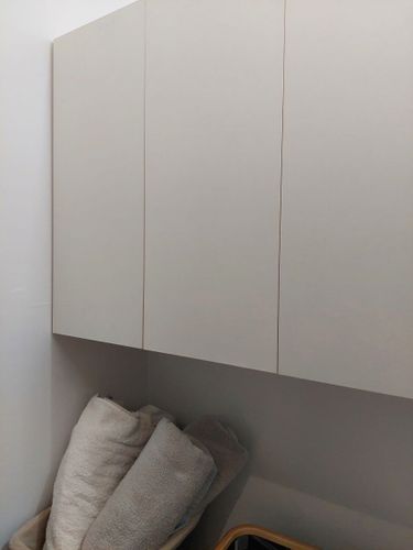

I don't have end panels on mine. I really wanted a clean look. I designed the timber shelving in the middle (1200mm length) to push the white cabinets on either end ( 300mm + 600mm left and 300mm right) right to the corners. Maximising the 2400mm space completely ! Here are some photos.  
300mm + 600mm cabinets  - Attached to the back and side wall.
300mm - Attached to the back wall only.

So @Chaks_DIY sorry to keep bugging you, but did you leave a small space at the sides of the cupboards closer to the walls to allow the doors to open properly?
It looks like it in the pictures. If so, how much space did you leave

No worries @rubytuesday1953
The hinges allow for the doors to open with no need for a gap between the wall and cabinet so you are fine there. Pretty cool how hinges work ha!
The right cabinet has a small unintential gap but my photos that make it look worse than what it is.
