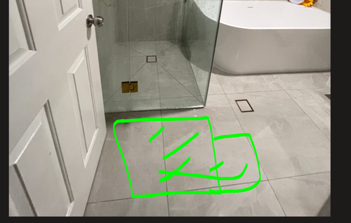

1. When I finished the shower, I saw a lot of water coming out of the frame and stagnant indicated on the green below.

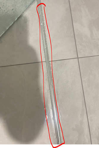

Upon close inspection I saw that door is not completely shut on vertical part of the frame door ( he is coming tomorrow to inspect, hopefully fixable). The vertical movable part of the showerhas rubber along the vertical end. And, on the floor, there is a metal part (indicated in Red), which I think is not blocking the water.
To my understanding, the rubber part on the vertical edges and metal part on the floor should work to help the water fall inside the Shower Screen. Correct me if I am wrong.
2. Is this how frameless shower screen works ? Is there any solution to fix this and hoping he will have some solution too. It is not always possible to shower facing towards the wall or away from the shower door.
3. If the water is outside, shouldn't the water be flowing quickly through the outside drain like the drain inside the shower screen ? Should the outside drain be getting rid of the water splashed outside the bath or vanity ( for any reason). Isn't its purpose same as the drain inside the shower screen, quick drain.

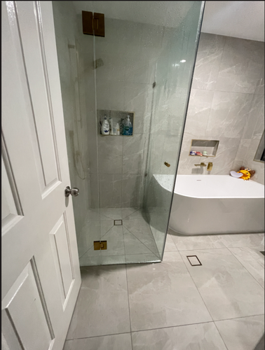

Following is my moving glass panel at the moment
Are you saying to apply more silicon on top of this metal bar ?

Hi @Sugar,
If water migrates under the bar, it likely needs some silicone sealant on the inside edge to stop this; it's an easy fix. Sometimes, water runs down the door and manages to escape under it and the bar below. If this is the case, adding a shower seal to the door's lower edge helps the water drip off it and into the shower enclosure.
Regarding the drain outside. Its job is to collect large amounts of water and stop it from flowing into the rest of the house. Depending on the gradient of the floor, it likely won't collect a small amount of water. With semi-frameless showers, you'll often find that people use a bathmat or towel outside the door to help with water splashes outside the enclosure.

Hi @Sugar
So what you are saying is when the glass "Door" is closed water is escaping over the edge trim out of the shower . . . yes?
If thats the case, it appears there is no plastic trim under the door itself. Sliding one of these in and trimming to length should fix the problem. Not there are two types, one that rubs along the top of that metal strip and one that has an angled section that deflects the water within the shower.

He came and put some silicon rubber ( I think he bought from Bunnings) and put on the vertical edge of another panel (where the door would shut) and the bottom edge of the moving door. It has stopped a lot of water going out. I am happier than before. I am going to see for another few days.
Looks like the silicon was forgotten to put or forgotton to be supplied by supplier. It has worked now.
Thank you for your advice.
