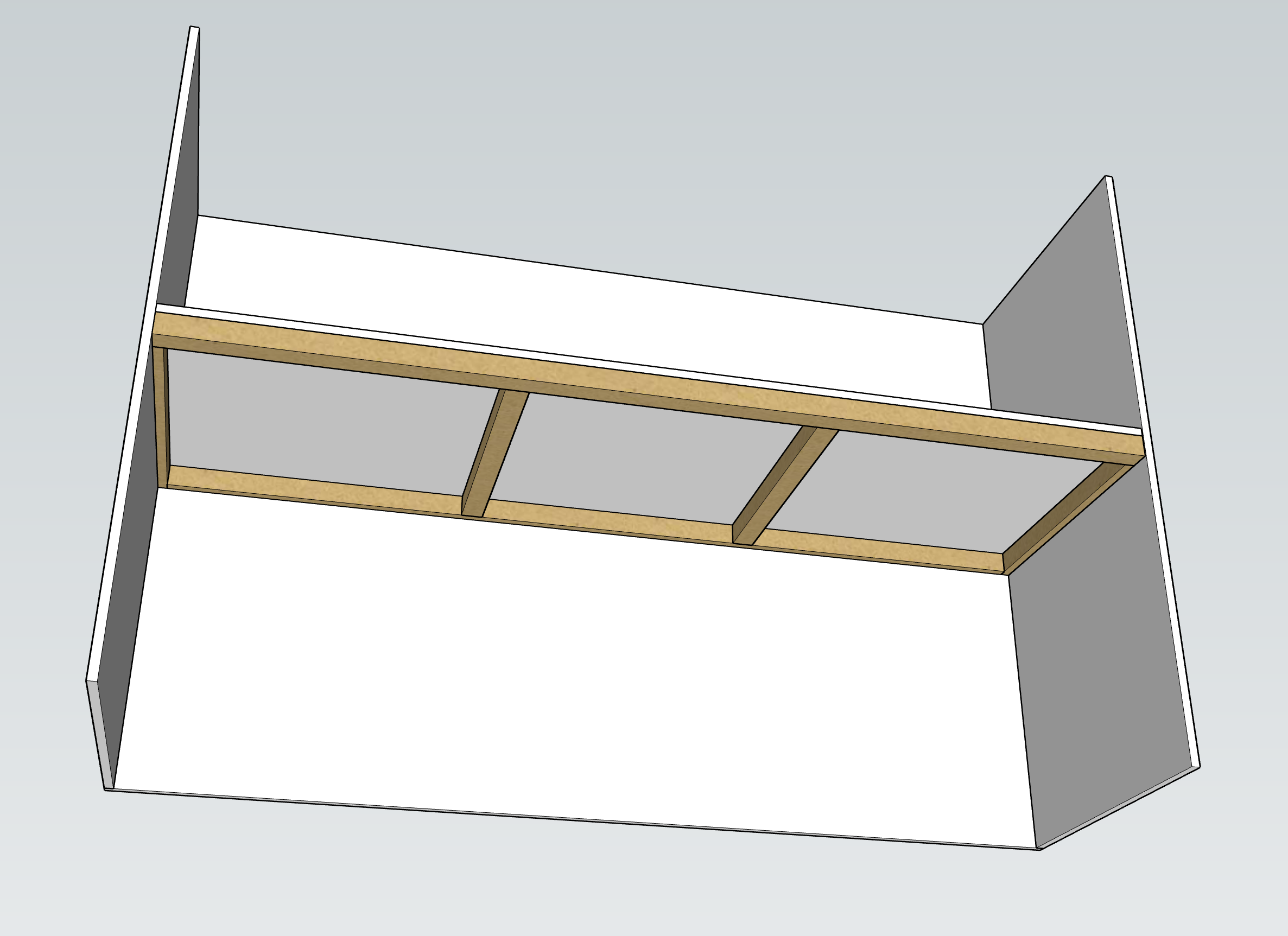

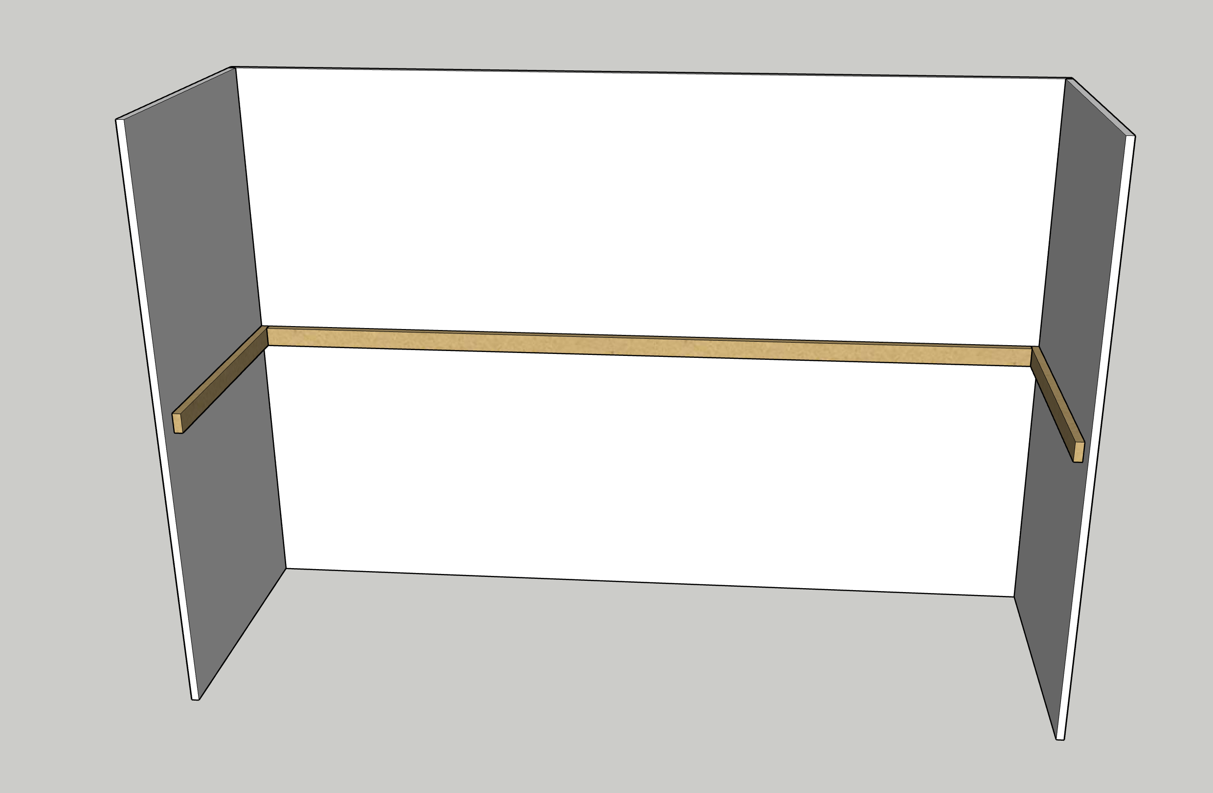

If you wanted to span this distance, you would need to look at adding cleats around the perimeter of the shelf and then strengthening the board itself so that it does not sag.
You could install 42x18 timbers to the sides and back of the cabinet using chipboard screws of a suitable length to go through the timber and into the cabinet carcass without going through the back. These screws should be spaced every 300mm or so along the full length of the cleats.
I would then suggest adding 42x42 battens along the bottom of the shelf at 600mm intervals and along the front edge.
Adding these timbers will help to stiffen up the board and minimise the risk of sagging over time.
