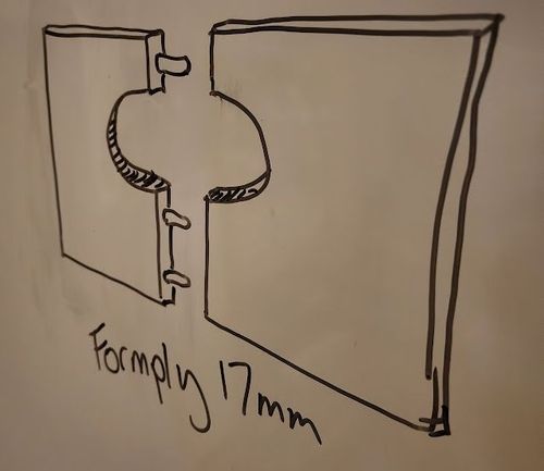

G'day @alamaro67
I freely admit to over-engineering things - tis me.
I love Formply.
https://www.bunnings.com.au/specrite-1800-x-1200mm-17mm-formply-f17_p0390220
I would buy a big sheet - cause I know I'd find other uses later. My wife would roll her eyes at me when I return with the trailer.
Fiddly at the back of a toilet - but I would try profiling the outlet so I would have two pieces coming together. One side would have a few dowels glued on one side only. Paint prior.
Just thought I'd toss another idea at you.
Cheers.
