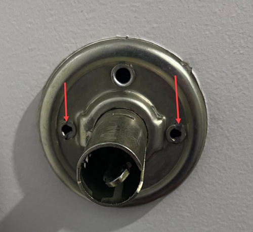

If you have some photos from different angles, this could help us see if there is anything that could help. Also, if you can shine a light down the centre where the spindle is and take a photo, this might also help.
If we can't find a method to release the lock or latch from this side, and there is no way to access the inside of the door, then you can aways use a drill to drill out the screws, which will be located behind these two holes.

Following @JacobZ second piece of advice, use a 6mm metal drill bit to drill out the posts which will release both side the handle face plates allowing you to push through the spindle.
This will expose the latch having a square opening. You will need a large flat screw driver or similar to insert and turn the latch mechanism.
If this doesn't work and you still can't open the door, then unfortunately it's a rare scenario that the latch spring has failed. If this is the case, then the solution is an advanced process that even the average handyman would struggle to perform without cause considerable damage to both the door and frame.
I detailed the process in a post a few weeks back for someone in a similar scenario, but let's see how you go with the instruction above first.
