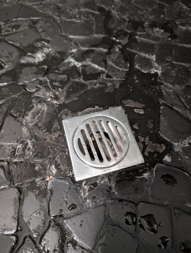

Hi
Need Advice please on the shower floor. Been using bleach to clean but now I think its removing the colour. What the best way to redo the floor

Hi @Elise22,
Paints typically don't require sealants.
From your images, I'm not seeing anything I'd call a sealant. You have slate-like tiles that have been painted over in a dark grey colour. In some areas, the paint is failing and chipping/flaking away, and in others, the grey paint has white stains, either from the bleach or just through hard water stains. These white stains are calcium deposits, which are very noticeable on dark surfaces.
Painting over slate tiles is not recommended, and that coating is now failing. At this stage, you might be best to paint over the existing failing paint and see how long you get. It's likely something you'll need to do every few years until you look at replacing the floor tiles.
Did you apply the grey paint, and if so, do you happen to know what type of paint it is?

Hello
We bought the house so the painted bottom was no us. I thought it was painted. I also tried clr as I thought calcium as well but didn't work.
