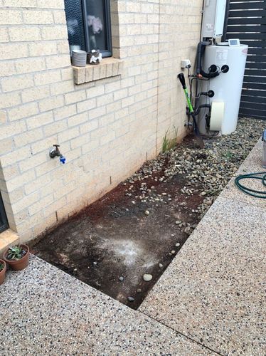

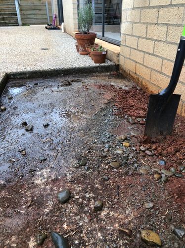

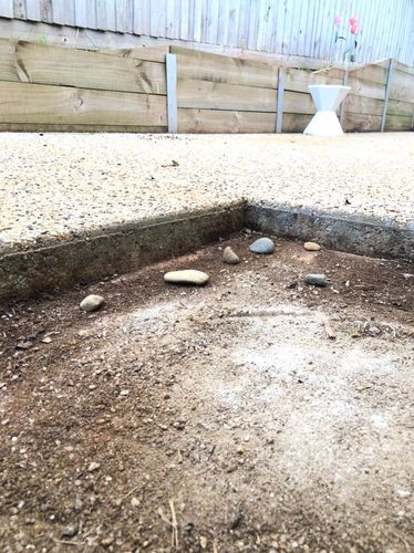

Hi all. Thanks for this lovely forum. I was planning to install an Absco shed in our side yard. My question was which flooring is the best. 1- concrete slab ( however it’s right next to the house wall and some previous concreting work on the opposite side. See photos. Do I need to do anything special to lay the concrete here)  as per my research we need some spacers next to the concrete edges. Or 2 - Matrix shed panel ( the hard plastic flooring option for sheds)
the space is 2 mt x 1 mt. The shed I am planning is 1.52mt x0.78 mt. The current floor looks like is of uneven concrete base for some part and just soil the rest.

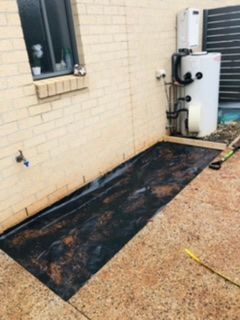

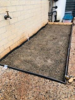

Absco sheds are designed to be bolted down to a concrete slab. Since your area is boarded by concrete and a wall on three sides, you would use expansion joints on those areas. Bear in mind that you don't want to cover those weeper holes in the brickwork. The fourth open side will need some formwork built to retain the concrete while it sets.
It would be a great idea to lay some GRUNT 2m x 5m Black 200um Medium Impact Pro Builder's Film Handy Roll under the new slab to prevent moisture from rising through it and entering your shed. It also wouldn't hurt to add reinforcement mesh in the slab to help prevent it from cracking.

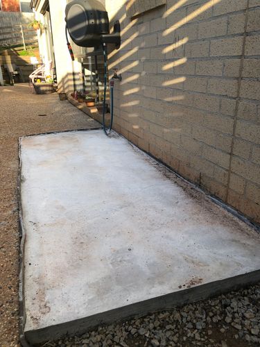

Re: Best footing for garden shed floor?
@MitchellMc thanks for your help.

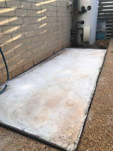

It’s been some time coming but I went well with laying the slab. You live and learn. Now just time to get the shed and invite a friend to build it with me when the lock down ends.
That's sensational to hear, @wannado and what a cracker of a slab that is! It looks like you've done an amazing job, and it will be a perfect foundation for your future shed. You'll have to give us an update on the finished product once all this business ends.
