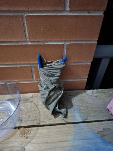

After cleaning the rust off tools then simply  soaking them in oil the wrapping tools in a ragg, hence,  eg , my  scecitors nicely oiled

Do you have any photos of the tools without the rags?
It'd be great to see how they look after a coating of oil.
Did you use something like linseed oil
I have heard it is a good method for restoring tools like this.
Thank you for sharing.
