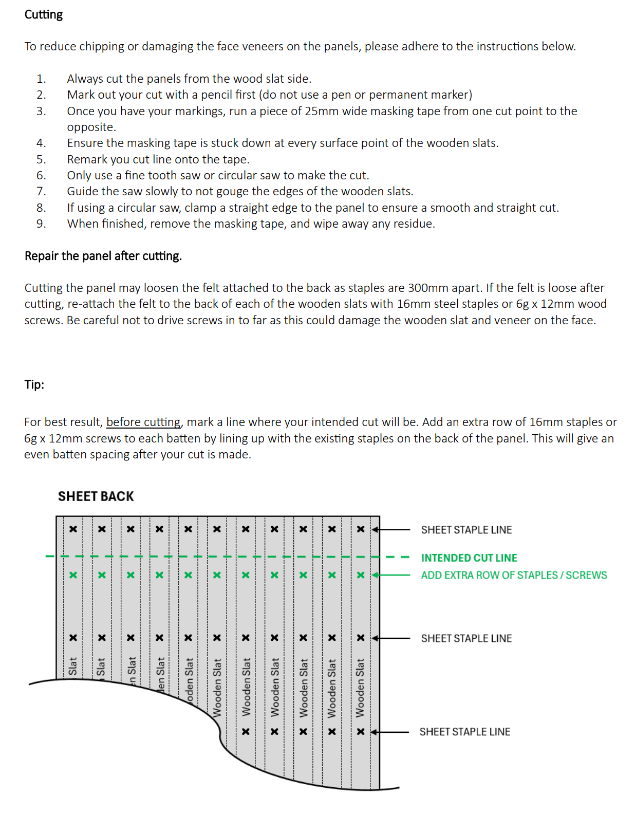

Hi team, We're looking to upgrade our space with SpecRite Oak Timber Acoustic Panels.
Wondering if bunnings offers cutting service for this? we just need to reduce the length. We have had cutting done before at bunnings but not sure about this one in particular. We will need 6 cuts in total (6 panels)
Welcome to the Bunnings Workshop community @gaggybhan. It's wonderful to have you join us, and many thanks for your question about acoustic panels.
As this isn’t just a straight timber panel, unfortunately we’re not able to cut the SpecRite Oak Timber Acoustic Panels on our saws in store due to the felt backing and the nature of the panel. The good news is they definitely can be cut at home. You can use either a fine-toothed hand saw or a circular saw to trim them to the length you need. I’ve included the manufacturer’s cutting specifications below to help you get the best result.
