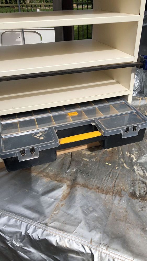

I have a few of these storage containers for screws and small parts, I decided to make a trolley that holds 8 of them for easier access.
I had the melamine sheet which was previously a stationery cupboard that I bought at auction for $20 and originally dismantled it with shelves in mind.

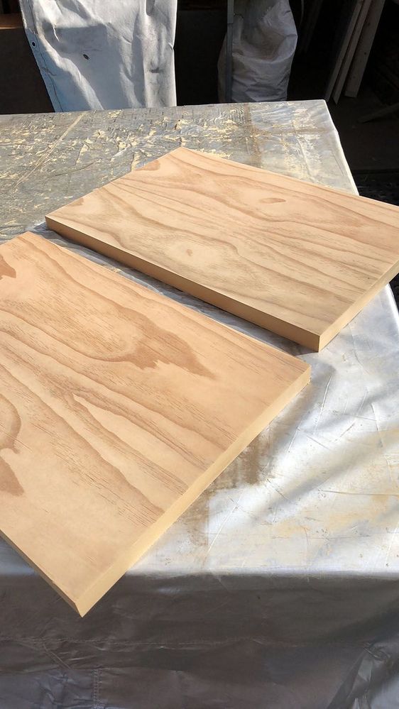

I cut out 2 side panels at 350mm deep x 1000mm high then used a 5/8" Dado stack to cut 5mm deep dados (grooves) in those side panels to support the shelves.

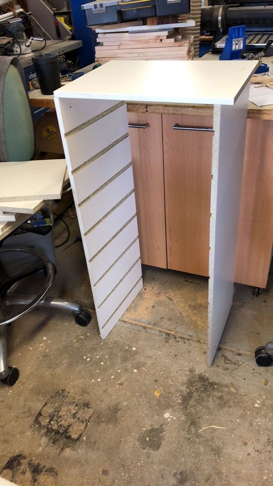

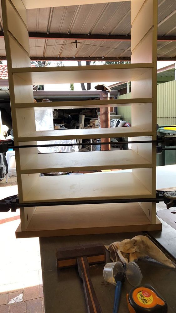

With a lower shelf dry clamped in place I screwed the side panels to the top and then the base panel.
Once the base and top were attached I then proceeded to glue in the remaining shelves.

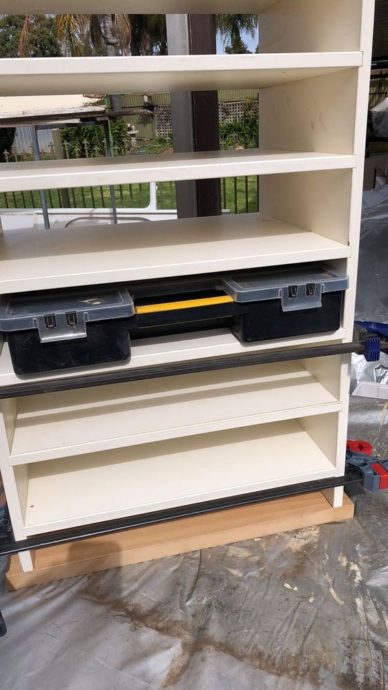

And a preview of how the storage containers would fit.

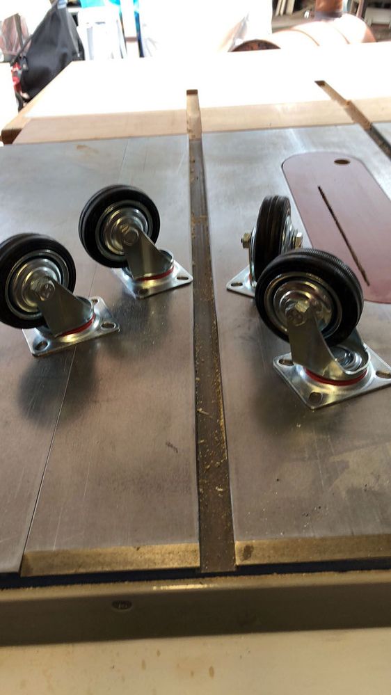

I had some wheels on hand that I bought a few sets when they were on special, marked them out and screwed to the base panel.

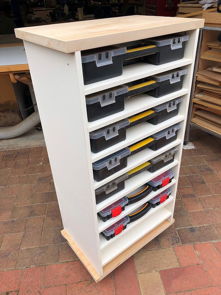

And here it is all done, a convenient roll around trolley/cart with all my screws and fasteners all in one place.
