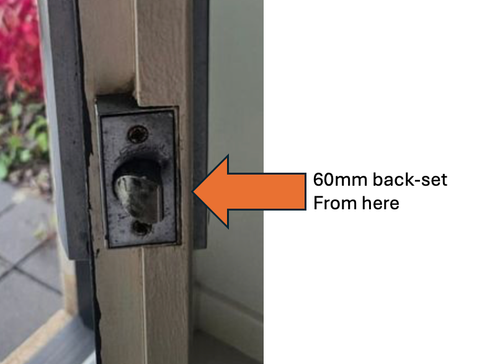

Hi @pauloguanaes
That rebate kit @JacobZ has linked in is perfect. In fact I'm glad its been mentioned as I didn't even know they were available and always made my own.
The only point I can add is to ensure when measuring the 60mm backset for the deadlock, is that its measured from the furthest edge of the door.

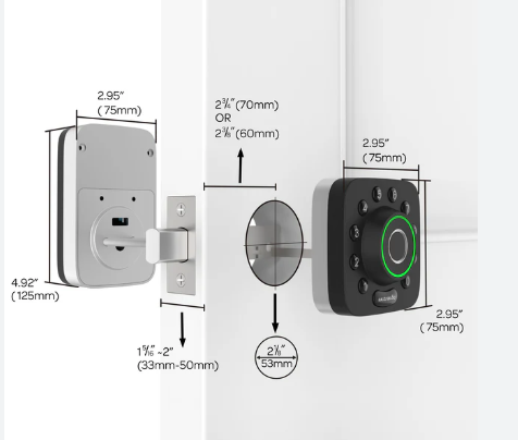

The Deadbolt I will install is a ultraloq u-bolt pro wifi (image below). Would that Rebate you posted the link work with it? Thanks.

Hello @pauloguanaes
There is a very good chance that the rebate kit will fit, but before you purchase anything, I suggest using the existing rebate set that is attached to your door already as it might fit as well.
