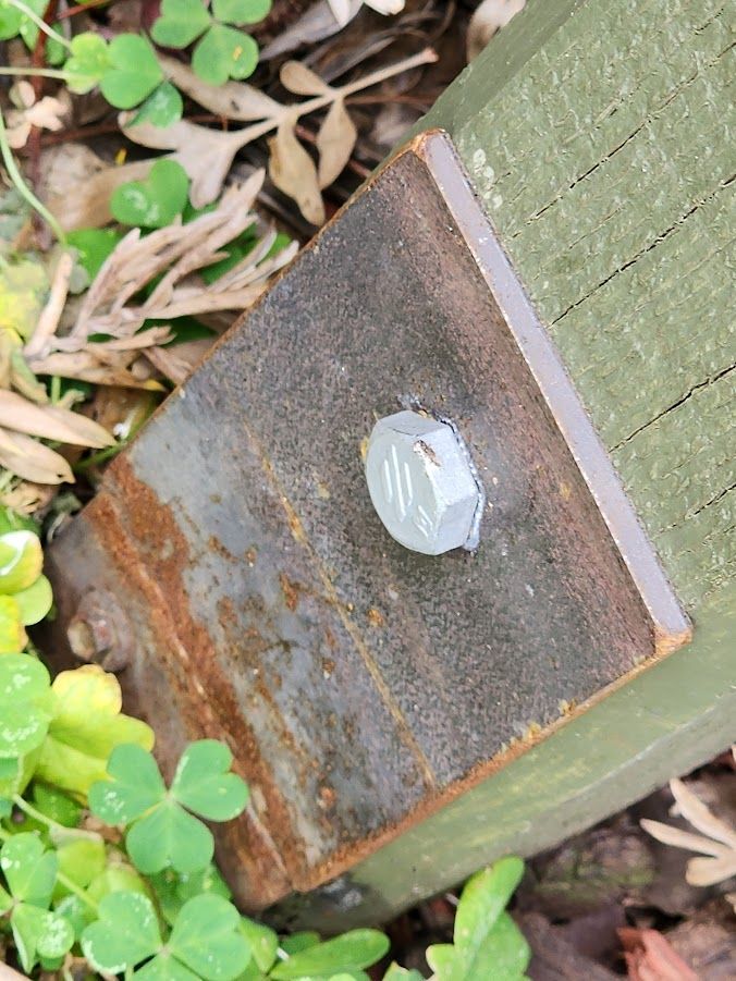

Another band-aid solution from me.
You can just make out the ineffective TEK screw at the bottom of the photo.
I welded two steel 5mm plates onto the existing stirrup vertical members with pre-drilled 1/2" holes.
Drill both sides till 'they meet.'
Insert bolt and nut.
I will be dead before the rot reaches this point.
