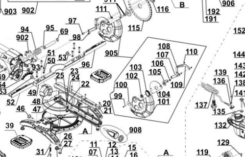

Hi @magsc
The mechanics of a retracting guard typically involves an arm with an elongated slot which some form of metal but most likely plastic pin slides along. If you have already checked and cleaned all other moving parts, ititss possible this pin is damaged/missing preventing the arm from moving freely. Though not likely it could be the retracting spring has lost some of its springing action.
If you go to the product page and download the parts diagram, I would start by dismantling the guard and working your way through the condition of the parts.

Re: magsc
As a 'retired' electrical draughtsman - I've always found those cutaway schematics in tool brochures - utterly appalling in quality. 😁
Maybe some photos @magsc would help the diagnosis?
