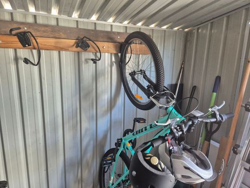

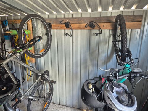

Thanks Jacob I've attached a couple of photos yeah it is a small shed but im hoping I can still hang the bikes. My thought is to get some 70×35mm pine and secure with some tek tapping screws from the outside of the shed. Then I could secure a sheet of 12mm ply to the timber and then attach the steadytrack bike racks to the ply. How does that sound?

To tell you the truth, I'm not a huge fan of hanging anything with considerable weight from a corrugated iron sheet because there is potential that the sheet will fold and collapse under the weight. Those sheets aren't made of thick metal, and they aren't designed to support weight. The main thing that gives them rigidity and strength is their corrugations and the framing around them.
Could you maybe bolt a steel post to the slab on the right of the image and then run some framing between the post on the left and the new one?
It might seem overkill, but I just can't see a corrugated iron sheet being sufficient to hold the weight of multiple bikes long term.
Let me know what you think.
