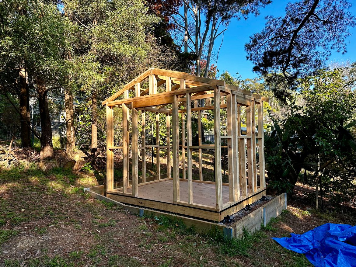

Hi @Old-gal24 I'm afraid it hasn't changed much, I had to divert funds to other life stuff but I'm ready to get going again with Colorbond cladding. My design was based on some plans I bought but then I re-did them in some 3D software called SketchUp, mainly to help me really understand how it was put together but I had also been meaning to learn it for other projects. I was very close to just using the plans straight up.
My suggestion would be to download some simple shed plans at least as a starting point, the only issue I had was finding metric plans, here is where I got mine from - https://www.icreatables.com/metric-sheds/metric-garden-shed-plans they have instructions on how to build too which I found helpful.
I also spend hours watching various YouTube videos on how to build a shed, you want to avoid the super fancy ones though. Some great examples.
https://www.youtube.com/watch?v=FD0_2aO_3so&list=PLSz5m-KXTSM8EiSh7njlvkurO7NOyTo-0
https://www.youtube.com/watch?v=BLk_CAMmQPc&list=PLLO3yW3SG0-CewhxV3q4v6qRkHVwLjXXR&index=3
I would suggest creating your own post so the awesome folks on here can cater their advice to your specific needs. As you can see on my project post, they are helping me every step of the way, and feel free to tag me in that post if you think I could help in any way.
This is where my shed is at the moment

From your photo above it looks like the hardest part you have already completed.  This was exactly what I had planed to make, but thought the roof would be to difficult for me to manage, mostly on my own.
So I decided to go with the skillion roof line, hoping that all of my back neighbours trees/foliage should slid down the back where I can rake it out each year when the trees have finished dropping all of their leaves.
