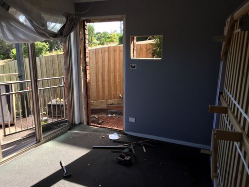

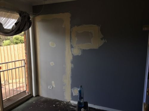

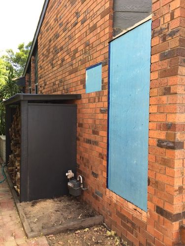

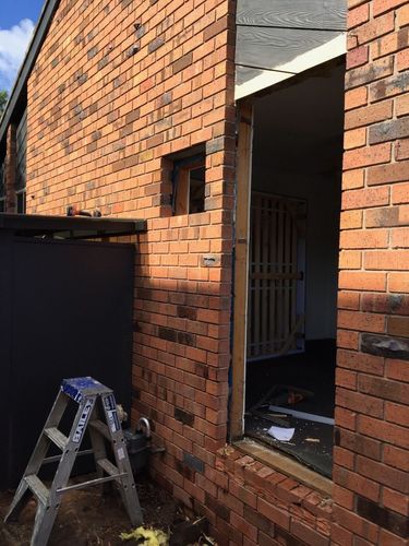

Below are photos from performing the exact same task which is also inline with @JacobZ post. I made two frames out of 90mm x 45mm framing pine, one for the internal wall and one for the outer. The internal wall was nailed into place a little shy of flush to allow for the plasterboard stud glue. The outer frame was secured with construction liquid nails and masonry fasteners allowing for Blue-board to be flush fitted against the brick as I was rendering. Earthwool insulation was fitted before the cladding was fitted. Then I used Sikaflex to seal the external gaps. If you not rendering you could either apply another more decorative gladding like vertical pieces of 38mm x 38mm Merbau with a small 10mm gap in-between. Or replace the Blue-board with weatherboards..

My answer is the same the rest of the guys have suggested I like @Nailbag's photos showing what he did and how it can look. The concrete sheeting/blueboard on the outside to make it secure is the way to go. Then you can paint or render if you wish.
