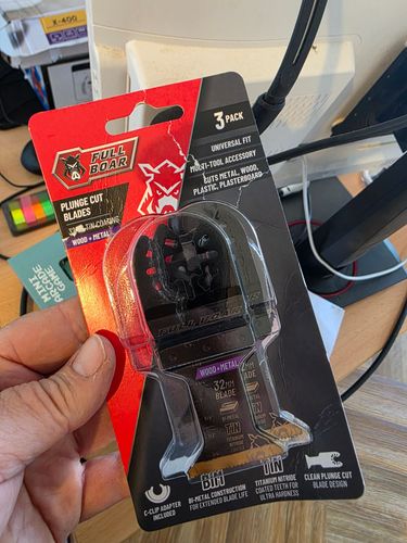

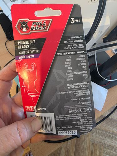

Re: How to find blades for Ozito Multi tool?
I just bought the Full Boar blades. They say ozito compatible.
but they do not work. They won't go on straight so have to put the blade at 90deg to the tool. When hubby went to use it and the blade fell off
