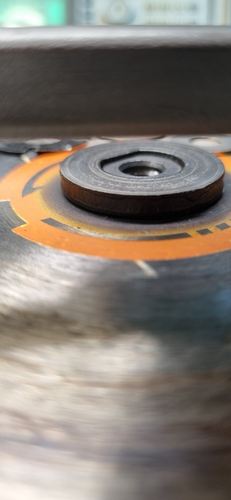

I double-checked with the AEG technical team, and they confirmed that the flat side of the external flange goes against the blade and not the tapered side. I mentioned your observation, and they are now looking into the image as they believe the flange is pictured in the incorrect position.

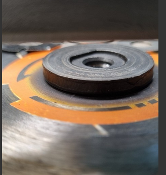

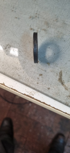

It will be very interesting to see what AEG come back with. I had a look at French and Russian YouTubes with the KS12-1 and they definitely show a wide outer flange with a very obvious taper as seen in the schematic on the first page.
But Googling (eBay - Cashies - Cash converters) in Australia - I keep seeing that flange @gencomm has - flat, coin like with no taper.
Continent based changes perhaps?
I think what looks like taper on @gencomm's photo is shadow?

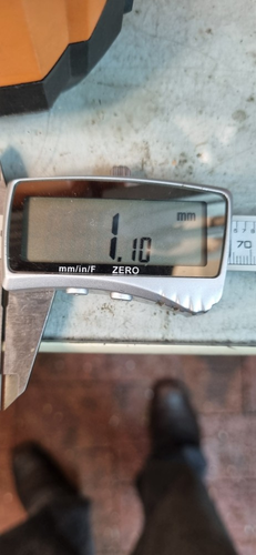

I have already done that. the tool specialist was polite but unenthusiastic. there was nothing to show me anyway. as packets were sealed and the appliances mounted and locked to displays. there were no spares to buy
I was not powering the machine up, but looking at the tolerances.
these seem to me to be ok....Except, as I said, the spring washer my have been overheated.
ps in spite of the photos looking like it is ready to go, the saw has not been operated. I am aware of the issues that may be caused by high RPM, balance and the blade remaining integrated.

I do think John has the outer flange in the correct position based on his photo seen above.
And no taper.
I feel my eyes can discern the machined out circular area - that you see on the backs of other circular saw outer flanges...

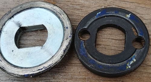

Back from the store, no real mysteries were solved. Can I get you to check whether the rear flange is in place and orientated correctly as per the image below?
Apart from that, it doesn't look like it particularly matters which way the front flange is orientated.
Silly question, but are you engaging the blade lock button/lever whilst tightening the blade? It's the black lever directly above the bolt behind the blade guard. It depresses and locks the drive spindle in place so you can tighten the blade bolt sufficiently.

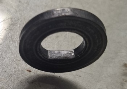

Reading the manual on Bunnings, it indicates an arbor of 20mm for the KS12-1.
Below is not an AEG saw, but it is a 20mm arbor. If you flip the inner flange you create at least one new impossible situation. A new 'arbor' size is created of 28mm - hence the blade will no longer fit. Plus of course, it no longer makes contact with the drive system.
I can only imagine the same for the AEG.
If I may be John's advocate - he must have the inner flange correctly installed - otherwise we wouldn't be seeing this on the previous page...
