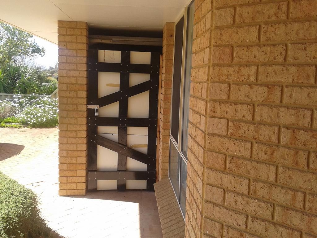

Ok thanks for the advice. I'll probably get started on this in a couple of days once the glue dries on my door.
Ok doors up, I bought the pine from a furniture maker in Baldivis who's retiring,20200907_113020-large.jpg a dollar per length so eleven dollars worth of timber.
I think the most expensive part of the project was the paint.
