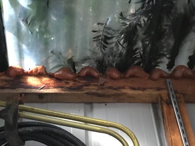

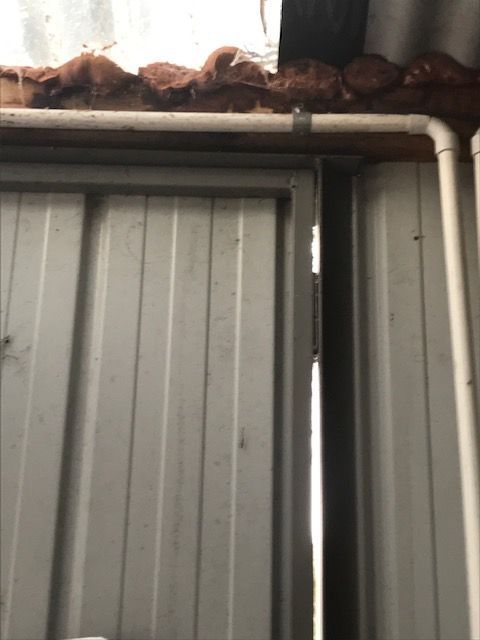

I've taken a few photos, it seems the concrete floor is still a good seal and the foam under the roof is doing its job, but the gap around the side door is obviously a problem! The big tilt door has a rubber seal which works ok. A lot of the mess comes from spiders and bugs, which I try to keep in check with the occasional insect bomb.

Many thanks for the additional images, that certainly helps illustrate the issue.
For the gap around the side door, I would suggest using some Hatch Seal Foam 6x18mmx10m Black to seal the space. This product has a sticky back and can be stuck to the inside edge of the door frame. When the door closes it will sandwich the foam in the gap creating a great seal. I would advise cleaning the surface which you are sticking the foam on with Isopropyl alcohol. This will make sure there are no contaminants and that you get a great bond.
The insect bombs work well to kill all the bugs in the area. They are not great at preventing insects as they only protect for three months. I would suggest using Richgro 3L Indoor Outdoor Surface Spray to compliment the insect bombs. This product protects for nine months and you should focus on spraying it over all the nooks and entrance points. Make sure you spray a saturated layer over all the possible entrance points and the perimeter of the garage.
