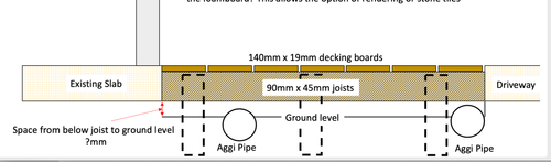

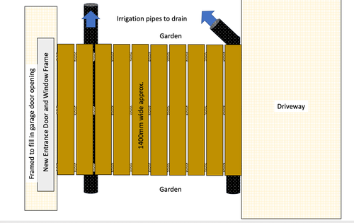

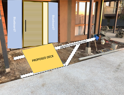

I have essentially done the same project as you, just turning a single garage into a formal entrance.
I twas able to take an easier option that I wonder if you have considered, which is to lower the groundwork in front. This is a much easier process where I installed an ag drain under and infant of the entrance the built at floor level a deck. Being non-solid and with a 50mm clearance plus drainage it complied with building regs.
