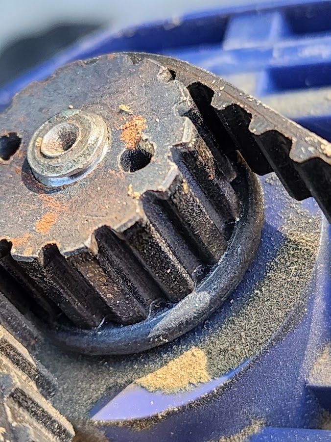

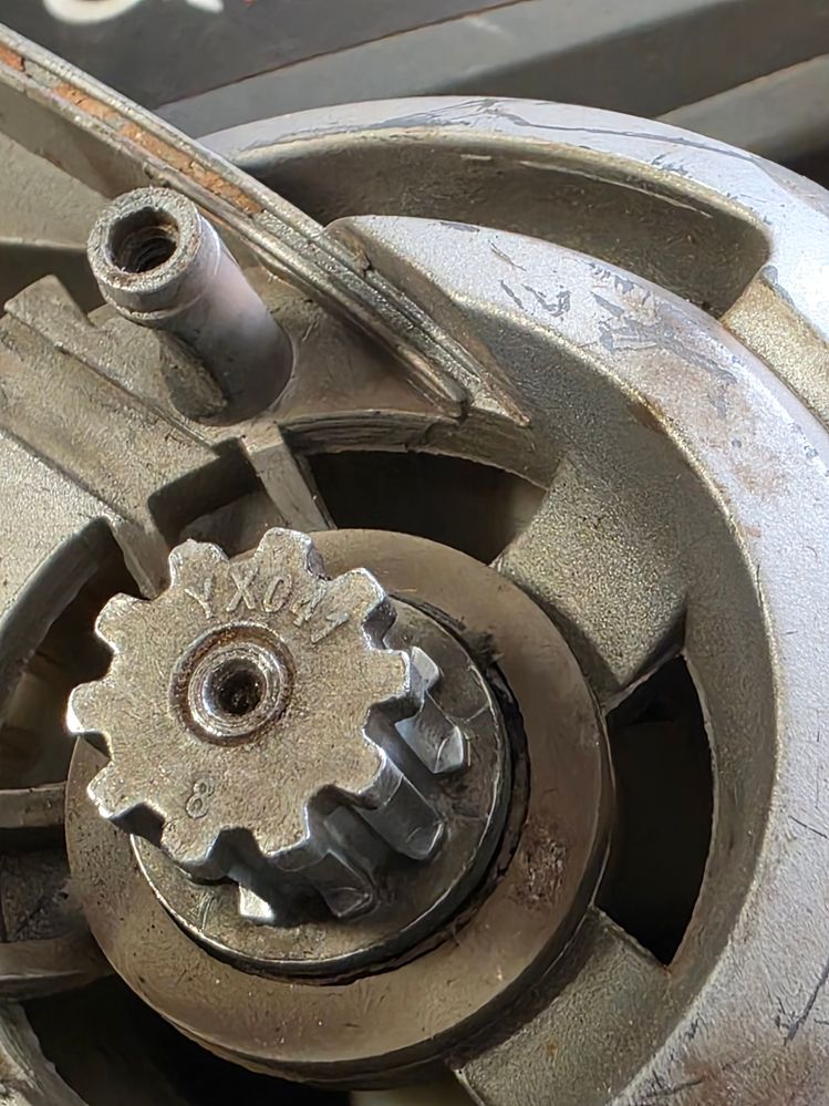

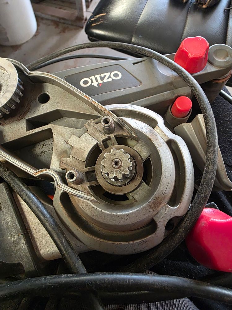

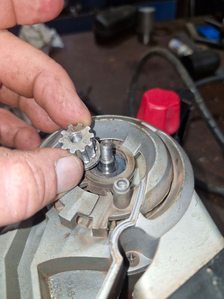

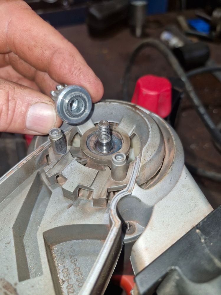

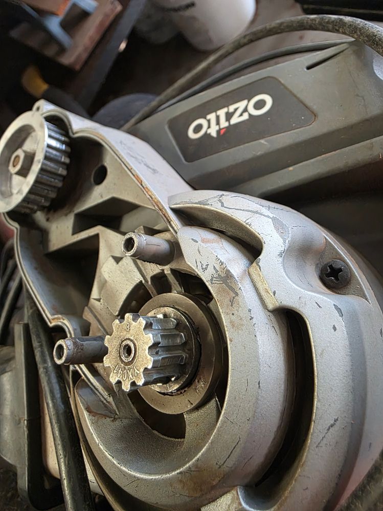

Hi All i have a small Ozito Belt Sander BSV-9000 and would like to replace the small drive gear.

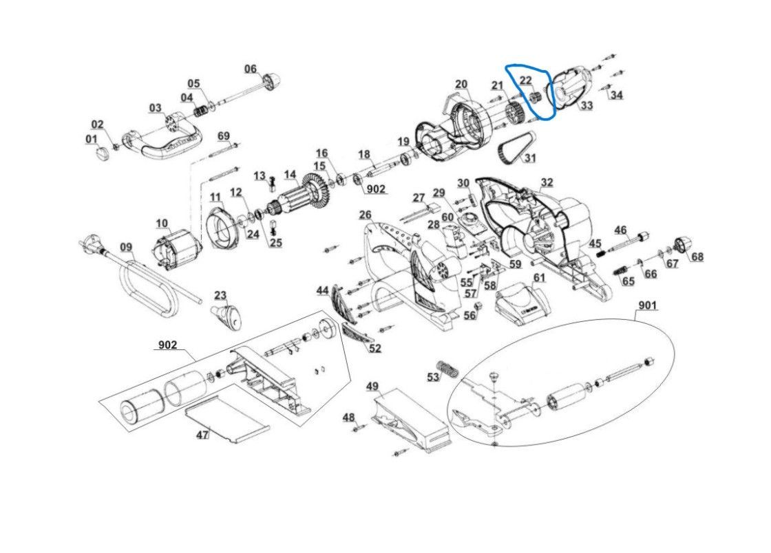

Parts diagram BSV-9000 4466238_21021_001.jpg1000003266.jpg1000003265.jpg1000003264.jpg
Hi All i have a small Ozito Belt Sander BSV-9000 and would like to replace the small drive gear nearly worn through.
Was wondering if anyone has had any luck with tracking down this part so i can replace it, sander still works fine.
Have attached some images of the drive gear so you can see what i'm talking about.

Have you spoken with the Special Orders team at your local Bunnings store? Take the sander’s model number, the parts diagram and the specific part number for the worn drive gear. The team can then contact the Ozito spare parts department and confirm whether the gear is still available. If it is, they can place an order for you. If it isn’t, they’ll be able to advise you on the next options.
On a side note, those gear teeth look like they were designed like that to capture the bottom of a ribbed belt rather than worn down. However, it could just be an unusual wear pattern. Could you show us the belt?

Thats an amazing amount of wear on those teeth even for a DIY model considering the drive-belt is toothed rubber. The tensioning gear looks pretty good still. I take it that even with a new belt it's slipping badly?

I am thinking the drive gear is fine and does not need replacing.
Some drive belts have a belt convex tooth profile to match the concave gear wheel profile.
I have come across belt drive hand tools where there is a mismatch (maybe that sander), belts with a square profile and more likely to slip.
Assuming correct belt tension during operation does the sander labor and is there excessive belt slip with any signs of overheating.
With the belt removed check all the components that are supposed spin/turn do so without any binding/dragging.
Also check that the motor spins freely.
Oh... check the belt.

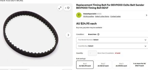

Thanks for the reply, got a new belt from someone on Ebay seemed to know exactly what belt was required.
Haven't fitted the new belt as yet, just trying to get the drive gear sorted first.
Interesting that it is called a Timing Belt.
Cheers
