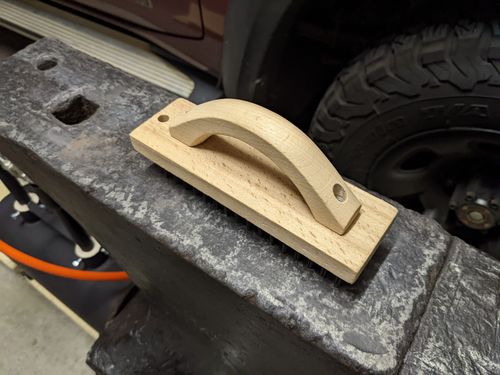

Furthermore, I needed a nice big wire brush for knocking slag off the heated stock and grabbed this Trojan jobbie from the local tool shop.
It wasn't exactly matching the scene, so I altered it slightly (at the cost of Trojan's great warranty of course, but worth it)
Hi @MartiPedia
Thank you so much for that update on your anvil project. Excellent alteration on the wire brush, it now looks the part and blends in very well with your anvil. The forge looks fantastic, it must have been a lot of fun operating it and heating up the steel.

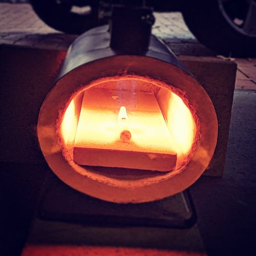

I'm keen to learn more about your forge. Details please. ![]()
Hi @Noyade
Let me tag @MartiPedia to make them aware of your question. Looking at the forge set-up, it looks to be gas-operated and made of a heat resistant ceramic. I am curious though if that internal heat is kept in or is transferred to the outside body of the forge.
Ah yes let me give you all the details. It's really quite a remarkable piece of equipment.
I'll preface the what follows by saying that I tend to do a LOT of research before committing to purchases like the forge. I considered everything available locally, their country of origin, prices, sizes, warranties, you name it. I decided on this specific forge because it's a well known brand, used by enthusiasts internationally and it's REALLY cheap considering what you get in the package while being pretty reasonable quality.
The forge is a dual burner oval forge produced by a company named Devil Forge who is based in Lithuania. If you're familiar with BigStackD's channel on YouTube (Perth based), you'll know that he's a massive supporter of Devil Forge and also offers some discount codes and information on their products. They were running a 25% discount promotion on eBay so I ended up getting the forge for just over $200, including shipping from Lithuania to Melbourne which took exactly 3 days. This blew my mind. Also, #AfterPay.
The kit was very well packaged and included the following:
Assembly is a breeze, with the most difficult part being the painting of the actual refractory cement and having to wait a day or two for it to dry before firing the forge for the first time. Fire it too early, and you risk weakening the final finish.
The burners operate between 0.1-0.16 Mpa / 14-23 Psi and are guaranteed to bring steel up to welding temperatures or 1400 degrees celsius. They can also be operated independently for smaller items by means of an isolation valve on the manifold that connects them. Both burners have chokes at the top that allow you to control the gas / air mixture independently as well. This is key as without this feature, the burners can't be optimised to reach said welding temperatures.
Using a $9 baggie of vermiculite, I have successfully used the forge to anneal an old punch I had laying around and intend on making a knife from. It's really killer value for money. I'm looking forward to purchasing a smelting forge from the same company.

Thanks @EricL! And to get back to your question, the forge does heat up on the outside to a temperature I'd compare to that of a car's exhaust after a long drive, but nowhere near the internal temperatures.
Apart from the surface temp, the 6" golden flames spewing from its open ends heat the garage up in a jiffy, even on these cold Melbourne nights
Unfortunately it also saps the available oxygen in mere minutes, so, fair warning, use in WELL ventilated areas or you'll be sleeping on the garage floor in no time.
