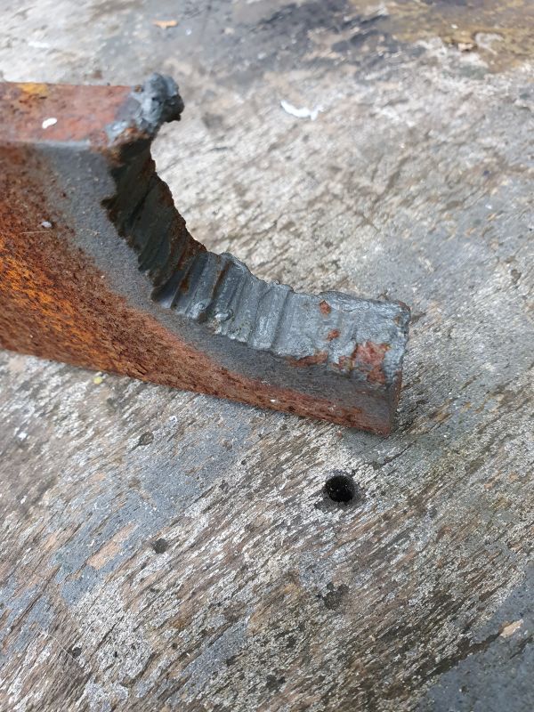

PS: Below you will see the welds I did where the ends of the flatbar met. I welded this in place because the strap sits in a channel and could not be fitted over otherwise. I did these with a little Ozito gasless MIG I bought last week: The new one, where the feed and voltage are both adjustable rather than just the feed rate. It works like a charm ![]()

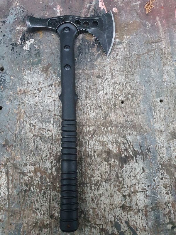

That axe / hatchet is the Aldi Camping variety retailing for $19.95 I believe. I know this, because I also have one 😋
I could make one yes, but I'd need two very specific blacksmith tools that I don't have yet: A punch, and a drift. These are used to punch the eye in things like hammers and axes.
I'd also need someone to either hold the work piece and the punch/drift or swing the hammer, because my capacity to do those things is limited by the amount of arms I have 😂 Alternatively, I'd need a hydraulic forging press (which I still plan on building from an old log splitter, along with a rudimentary power hammer). Forging presses are often used to simplify the punching of the eye when there aren't other people to help with the forging.
It's for this reason that I currently opt to make use of hammers / axes that have already got eyes and just reshaping them as needed. You'll be surprised how big a ball peen hammer becomes when you flatten it out 😬
