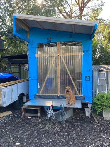

One of the difficulties of renting, or even sharing a workshop with someone else, is where to set up for a major project - Especially during winter.

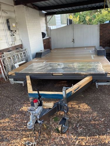

My solution was to build a workshop on a car trailer.
843E2545-D196-45C7-BCB2-0B9B456AC813.jpegI used mostly secondhand materials and constructed it in panels that would lay flat on the trailer if necessary.
Final cost was approximately $500 plus trailer.

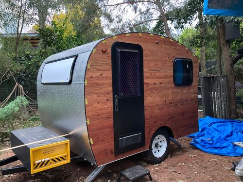

My project? The (almost completed) micro caravan.

I purchased the trailer for a tiny house but thought it might be a big step so started on the caravan to build up my confidence.
I’m not renting but I share a tiny workshop with a very untidy husband so the pop up workshop was a bit of a retreat and a place that I didn’t have to tidy up before starting work.
There are a number of advantages for building a workshop on a trailer, especially if the walls can be taken down and flat packed for relocation.
Also, trailers have a good solid flat base that can be made level.
But the best reason is that building regulations don’t apply to trailers.

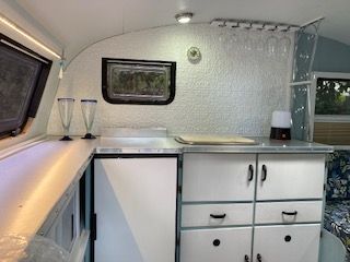

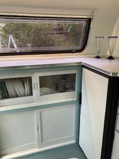

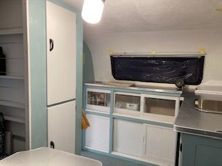

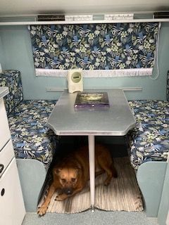

My caravan is 1.85x2.7m. It has a single bed/dinette.
I up cycled old kitchen dressers for the interior cupboards and put in a good size sink and 85L fridge.
It has a 45Ah lithium battery with solar, DC and vehicle connections for charging.
I have a camp stove which I will use for cooking.
I’m hoping to have it registered in a couple of weeks.
Today I succeeded in installing a flat window into a curved wall :smile:
Here are interior photos…
Sketchup has been great for designing.
Judith
