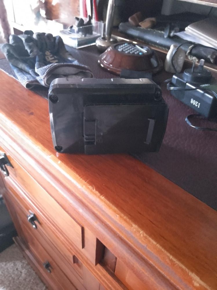

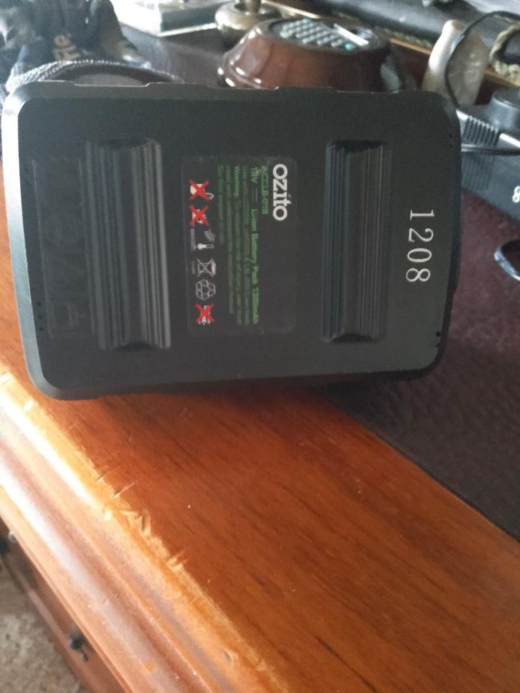

Ozito no longer sells the ACCLB-018 battery for my Ozito grass trimmer, but there may be a compatible replacement available. It's difficult to tell from the pictures on the Bunnings website whether there is something that would fit.
The charger says that the battery is fully charged, but the grass trimmer doesn't start.ACCLB-018 Battery
ACCLB-018 Battery under side
Charger
Hi @fino360,
Welcome to the Bunnings Workshop community, it is wonderful to have you with us.
Unfortunately, due to the age of that battery, it is very unlikely that there will be a suitable replacement battery. In saying this, the battery is relative to the tool, so if you can let us know the model number of the tool, we can get in touch with Ozito to confirm if any other batteries are compatible with it.
We will assist further when you can get back to us with the model number of your trimmer.
