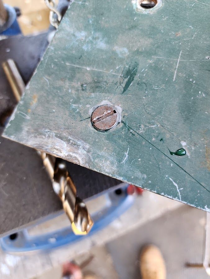

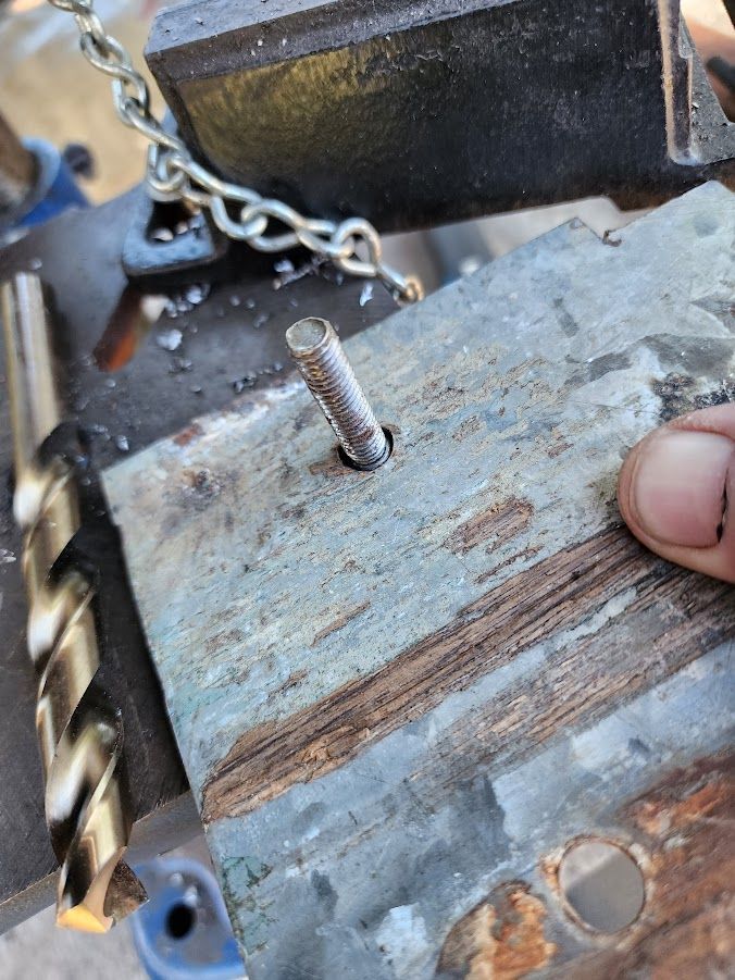

As requested here are some photos.

G'day @LynnieLightfoot
The Root Nuts that @AlanM52 mentioned look interesting.
But to my eyes there seems to be shadow in the television plate holes = a slight cavity?
Do you think there is room for the heads of countersunk bolts?
I was thinking of reversing your process - put the bolts the other way.
Making sure the bolts are the correct length or cut as required.
This is 2 mm steel plate with a very small countersink drilled.
Very little head showing - some of your epoxy. Allow to dry.
Bolt your telly plate back on.
The four projecting bolts should now connect to the monitor.
The dried epoxy should now allow you to tighten the four nuts.
