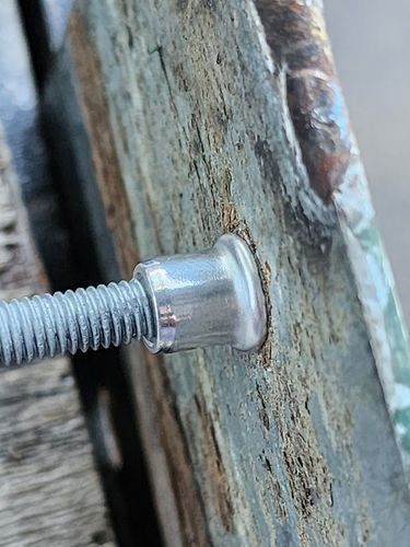

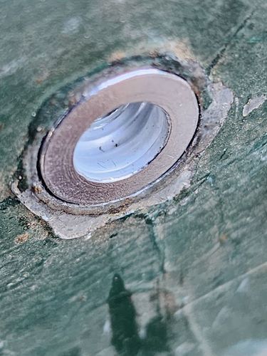

Insert a nut rivet.
This is a 6mm aluminium GasWeld rivet. The outer collar fits perfectly - absolutely flush.

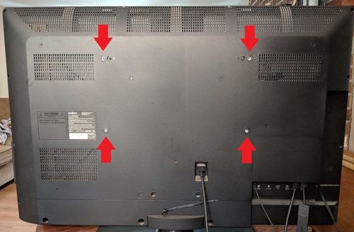

Nailbag
 These are typical mounting bracket nuts integrated as part of the back casing of a slightly curved back of a TV
