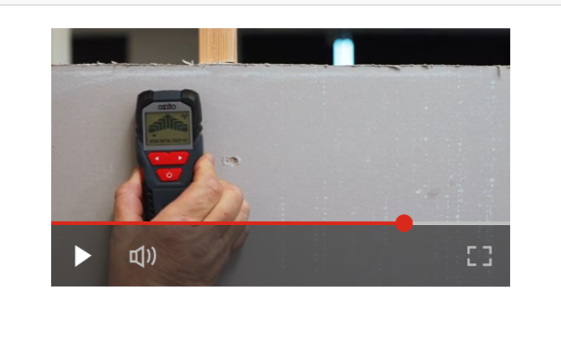

Morning @Old-gal24

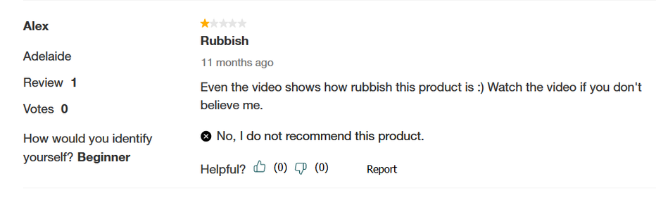

"BUT there was so much negative feed back on them that I thought I would steer clear."
I had a look at the reviews and noticed Alex who says to look at the video - for proof they don't work.
So I looked at it. But I'm not sure if Alex is saying the 'nose' of the 'flying wing' is meant to represent the centre of the stud - or it's a signal strength indicator for the approaching stud? Because as the finder continues to move right - I'm sure I see a 'shadow' appear which is meant to show the stud's thickness?
And is there some parallax error in the video?
Is that a single fibro sheet for the demonstration?
What does concern me is the nail/screw(?) so far to the right of the stud - that would upset the magnet method.
