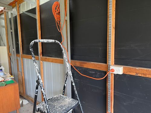

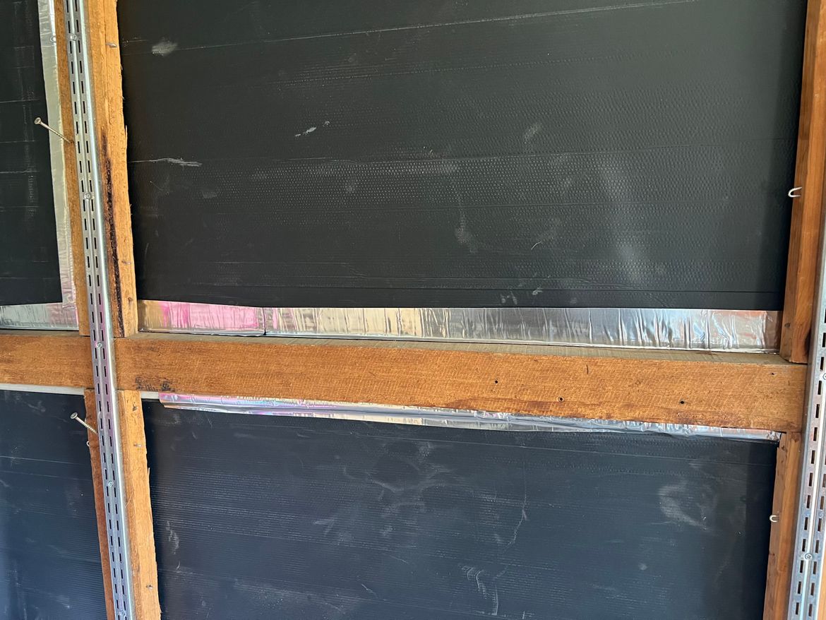

Re: wondering which sealant type for my garage...
so far so good...
Hello @AngelaJane
Thank you for the update, the seal looks good.
