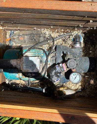

I’m seeking advice as to what type of tap timer I could use that will turn pump on for 1 hour a day to water lawn via pop up sprinklers. The power switch I assume would need to be on along with the tap which is located alongside the pump as per photo.

Did not spot it at first look, that's an extension cord weather cover with motor power lead plugged into extension cable - interesting.
We can't use a regular tap timer so instead I am suggesting a programable Smart Plug that can be controlled locally or via a phone app.

Basically the extension lead plug is removed and the Smart Plug is plugged into that power point and... the extension lead plugged into the Smart Plug. We need a photo of where the extension lead is plugged in and hopefully it is under cover like a patio area because the Smart Plug cannot be exposed to the weather.
