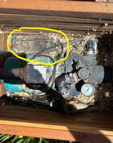

I’m seeking advice as to what type of tap timer I could use that will turn pump on for 1 hour a day to water lawn via pop up sprinklers. The power switch I assume would need to be on along with the tap which is located alongside the pump as per photo.

Did not spot it at first look, that's an extension cord weather cover with motor power lead plugged into extension cable - interesting.
We can't use a regular tap timer so instead I am suggesting a programable Smart Plug that can be controlled locally or via a phone app.

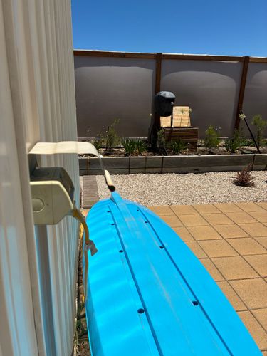

 Hi Alan
this is the power cord location, probably not really water proof, although EricL mentioned the Arlec cover not sure if that would be suitable any further advice would be appreciated.

AlanM52
Amassing an Audience
Re: How to connect a tap timer to my pump for watering lawn?
Hi @Garrygaz,
Yep... that's what I was leading up to it's not under cover so use a weatherproof box as @EricL suggested.
Hello @Garrygaz
My best advice is to make sure that the device you connect is protected from the weather. Another possible option is to get an electrician and have a weatherproof plug set installed under a covered area where you can attach a Smart Wi-Fi timer.
