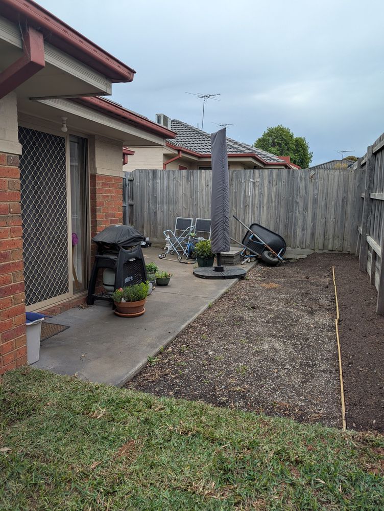

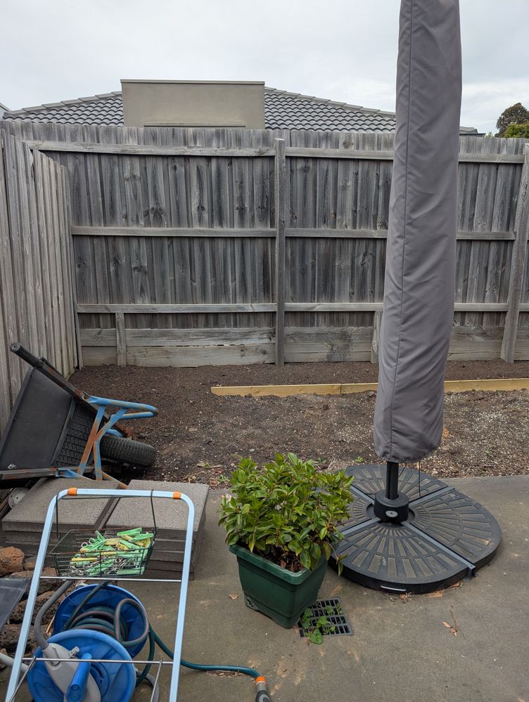

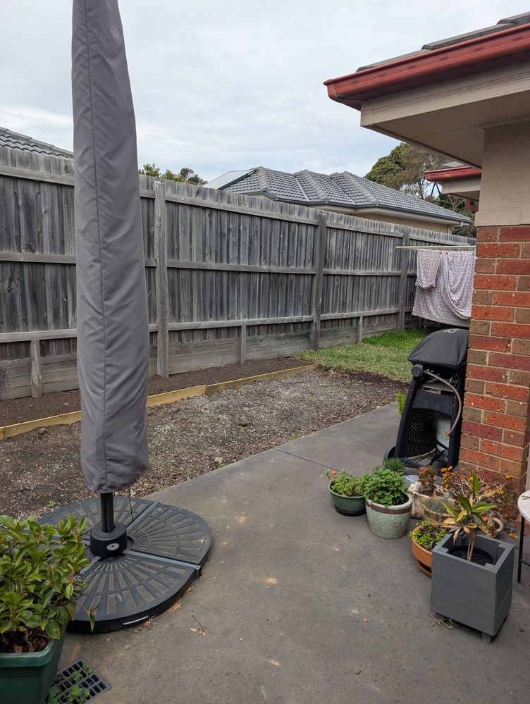

I'd like to build a frame for some climbers to hide my fence, but without adding weight that will eventually pull the fence down. My other option is to plant some trees but, as the yard is quite narrow, I'd like to keep the foliage as narrow as possible. I also don't want to lose the sunlight that comes in through the living room windows. So, nothing too high.

If you are looking to avoid adding weight to the fence then the best option is to have your frame separate from the fence.
There are premade options such as this Jack Tube Trellis 2.06m x 1m or this Jack 1900 x 600mm Grip And Grow Rustic Freestanding Plant Trainer, which are simply driven into the soil before planting. They are likely good options in your situation.
Another option is to use lattices such as these Lattice Makers 1800 x 600mm Diagonal Framed Lattice Panel and support them with Jack 240cm Black Premium Ultraposts. You'd simply drive the ultraposts 600mm into the soil, then screw the lattice to them.
Either option would work without adding weight to the fence.

The ultrapost with wire option seems like the most appropriate option for my space. There's quite a few meterage of fence and I wanted something as minimal as possible.
