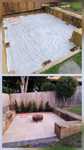

I know this is a few years old, but I have an easement with large stormwater pit. We created a fire pit area, first used geofabric leaving storm pit open, than laid drainage cell over whole area including on top of storm cover. Then covered with geofabric again. Finsihed with pavers. However the area with the storm cover we covered with stones to ensure clear drainage unimpeded by pavers. All water falls through to drainage cell and directly to open put. Also easy to pull up if council needs access

Hello @tophnay
Thank you for sharing your experience in regards to hiding storm water drains. Would it be possible for you to post a picture of your cover? This will give our members a better idea of what it looks like.

Unfortunately I didn't take before or during pictures. Just finished.

Hi @tophnay
It's ok, you can post a finished picture of the drain just to show how well it's hidden.

The geofabric in top picture has a piece over the storm drain cover as i was about to move debris and sand and didn't want it to go down. Bottom picture is finished and you can see the stone section along the garden edge which has drainage cell all along under the crushedsandstone. Storm water still flows to pit without issue. Pavers run towards drain.
