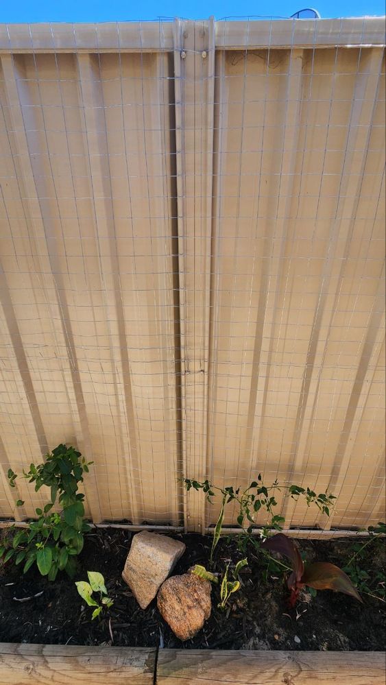

I'd like to do something similar - I was thinking of drilling this mesh to my fence and training Jasmine over it:
https://www.bunnings.com.au/jack-90cm-x-50mm-x-50mm-flower-mesh-galvanised_p3060289

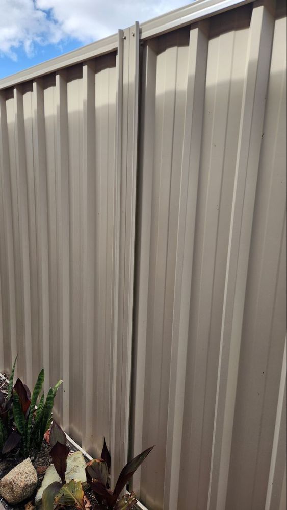

There's at least a finger's width of space if the mesh was sitting directly on the fence, and more in the indented bits:
I can also train it manually as need by tying it to the mesh.
Do you think this will work?

Do you know which of these tek screws match the colourbond in the photo?
https://www.bunnings.com.au/buildex-10g-x-16mm-clasic-cream-metal-c4-hexhead-no-seal-tek-screws-box-...
https://www.bunnings.com.au/buildex-10g-x-16mm-paperbark-metal-c4-hexhead-no-seal-tek-screws-box-100...

There should be no reason it shouldn't work as long as there is space for the plant to climb onto and is not being held back by lack of space. In regards to the colour, I think it looks more like paperbark than classic cream on the photo. But the only way to find out is to bring the screwhead close to the gate and do a visual match.

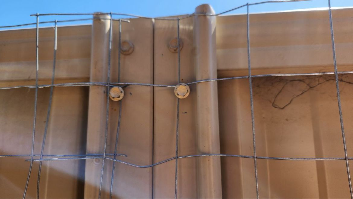

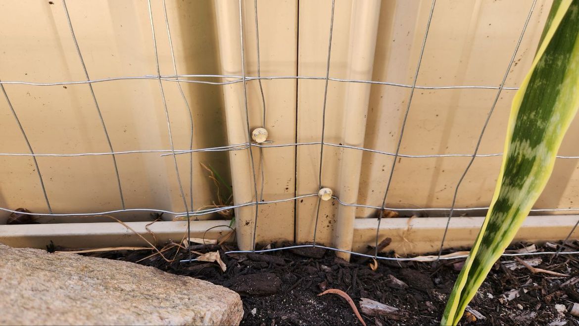

Re: install wire mesh to a colourbond fence
I ended up getting this:
https://www.bunnings.com.au/supatool-premium-8mm-1-2-drive-socket_p0067027
My drill is not great and had trouble getting the tek screws all the way in, so the socket wrench was necessary to finish them off (although it was still tricky because they wobble around a bit).
I'm quite happy with the end result, even though it's probably not the best work. It feels sturdy enough.
