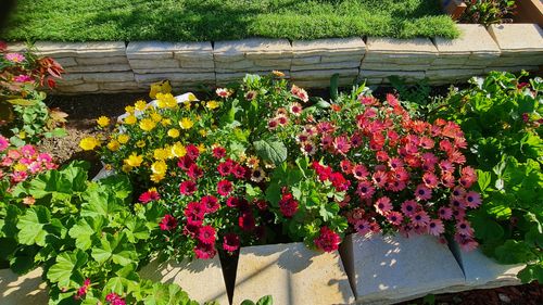

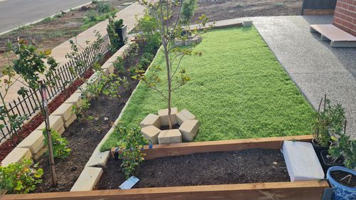

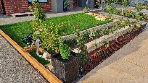

Completed the makeover of the front yard sometime early last year. Thanks @JacobZ and @Dave-1 for all your inputs!
Some pictures of the completed project from March 2025 with Roses, Osteospermum, Argyranthemum, geraniums, Lavender, Lemon Myrtle, Crepe Myrtle, Calendula
And the view after 6 months
