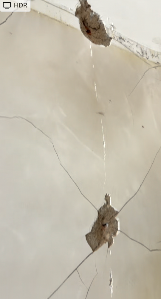

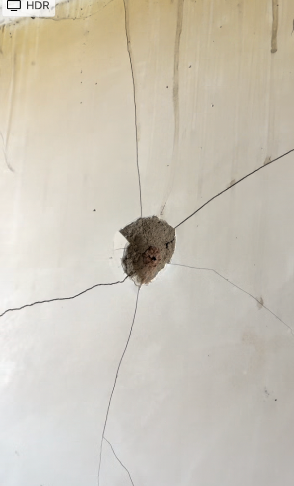

I just removed some old kitchen cabinets from an apartment that were secured on to the brick wall with large nails. We've removed the cabinets now which also removed some of the mortar that was placed over the brick, however the painted surface also now has cracks in it.
Do we need to repair the walls at all if we are putting new cabinets over them? Will it impact the longevity of how well the new cabinets will hold up?

It appears that when they used the concrete nail on the wall surface, they've shattered the render on the brick wall. Generally, if it was just a regular hole or small chip in the concrete render, I would recommend just patching it up with mortar. But because the damage is quite extensive, I suggest engaging the services of a concrete/rendering specialist. They'll be able to determine if the render can be patched or it will need to be removed and re-applied.

I agree with @EricL that this is more of a cosmetic concern with the top layer of the render, which would have been exposed in the homes earlier years. I would break away some of the loose sections and then take up Eric suggestion to infiltrate with mortar. If for no other reason than to keep it all in place during the new cabinetry install.

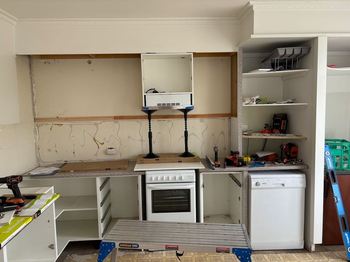

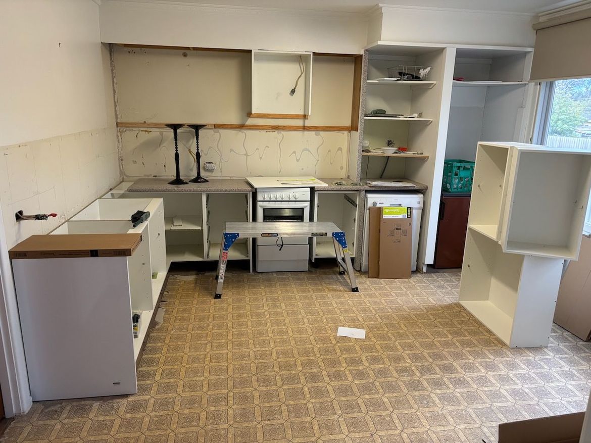

Some months back I installed a Kaboodle kitchen in a home that once I demolished it all exposed a similar scenario. Once the floor cabinets were installed I temporarlly fixed 42mm x 19mm DAR pine to the wall to rest the overheads at the right height. Then used adjustable lifters to support the front of them.
I pre-drilled corner holes in to the back of the cabinets and used a long-tipped marker to mark the fastener holes. I took the cabinets down and after drilling the holes in to the masonry wall, I inserted Ramset Multipurpose 8mm fasteners. Repositioned the the cabinets and secured them. Each cabinet was then fixed to the next via their side walls.

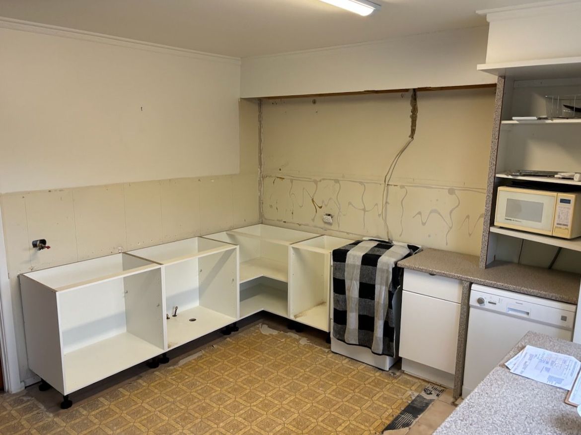

Then I went back and had a last look at your photos. Those long cracks from the center holes do concern me. They remind me of when I have used a ramset explosive gun that fires pins into concrete to secure things and the blow outs I associate with them.
Does the mortar around the cracks seem to want to fall away if you pry it?
Im still tempted to fill the holes, smooth and paint the wall then put up your cabinets and avoid the cracked and holey areas for the attachment points.

1: Did you patch the holes in the wall with anything before putting the cabinets in? In your photos it looks like there are some boards up.
2. Is there a particular drill attachment that is needed for drilling into the masonry wall?
3. did you put the cabinet back into position and then used the fastener screw through the cabinet into the wall?

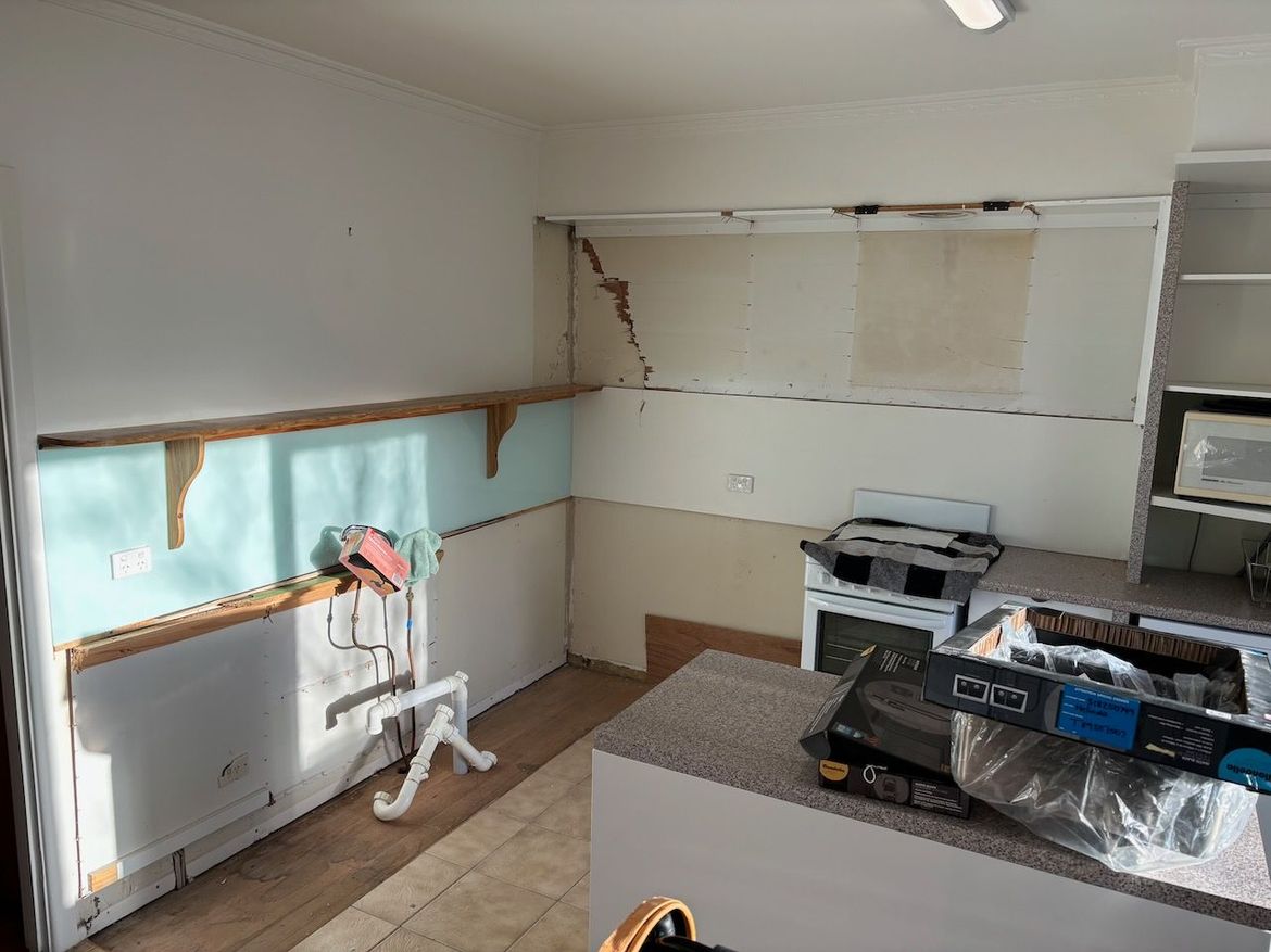

1. In the first photo it shows a few old leftovers from the original kitchen I dismantled. The left hd a pale blue polycarbonate splashback glued to a plasterboard wall. The back wall was solid concrete which just marking from the old cabinetry.
2. You need a hammer drill runnings on high-speed with masonry drill bits. 8mm in this case. You can use a standard DIY impact hammer drill for the job. In my case, I have a more specialised model designed primarily for more efficient masonry drilling. These use specialised drill bits as well. If you already have a cordless model tools I can recommend a suitable drill that uses the same batteries you already have. Alternatively, corded models though much cheaper wont have the same versatility moving forward with your handyman projects.
3. Correct. The first temp mount to the wall they were just propped in place So I could mark where to drill the fastener holes in to the concrete. Then removed them, drilled the holes and sat each one back up and fastened them one by one to the wall.
