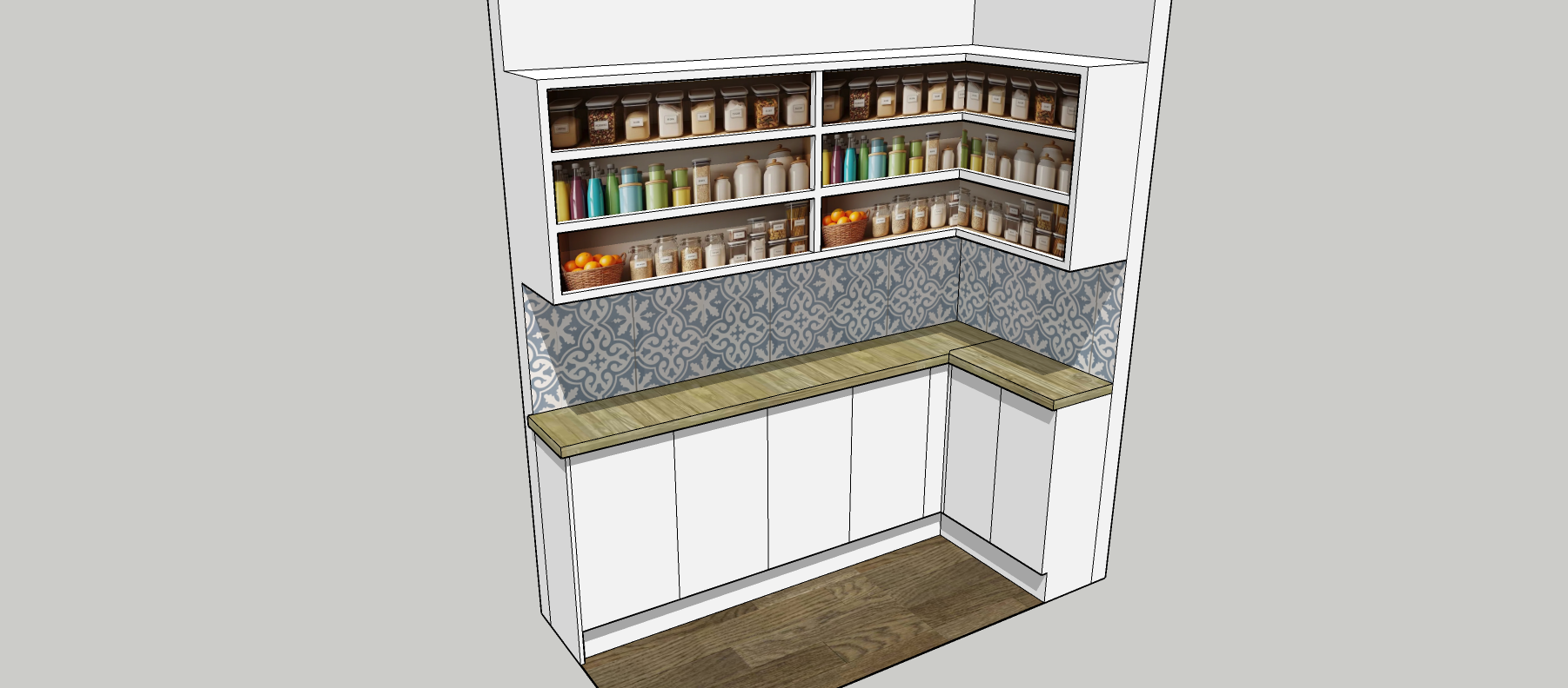

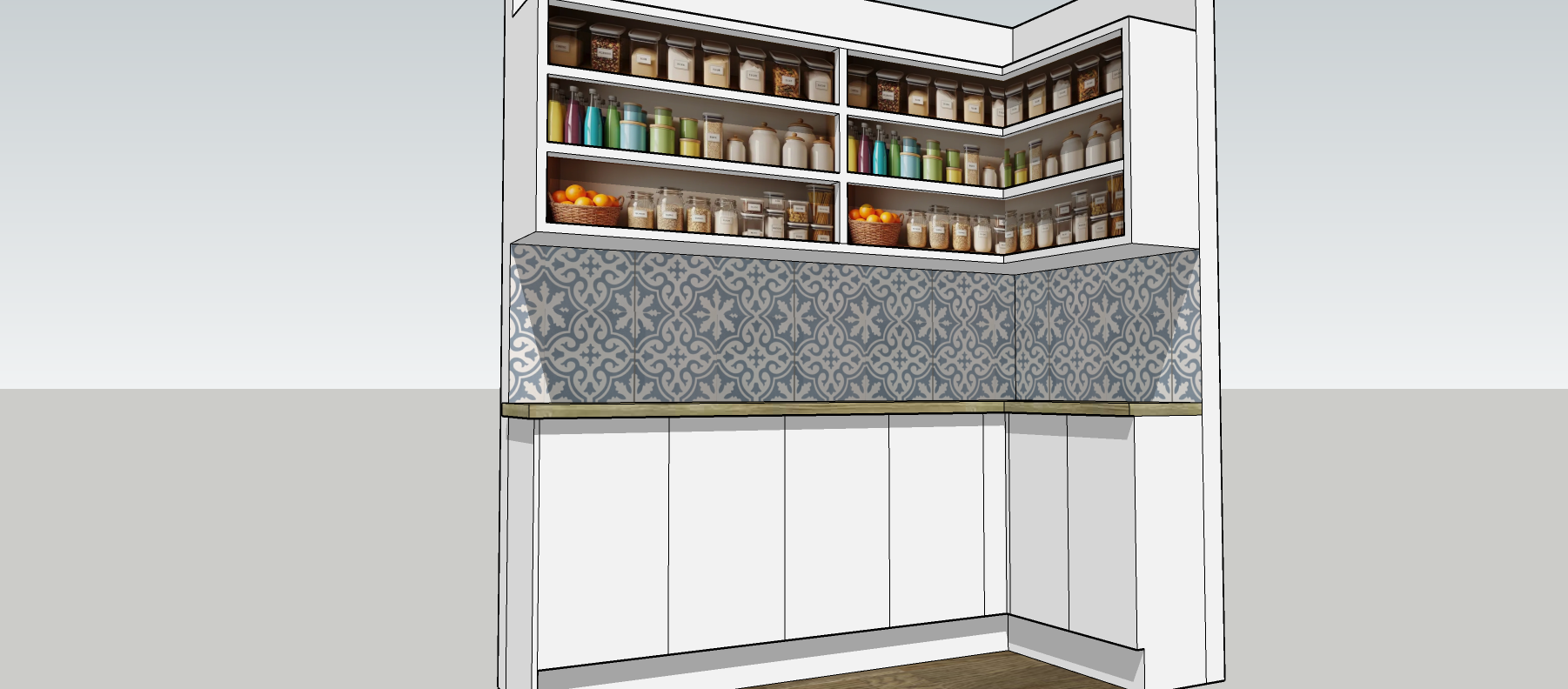

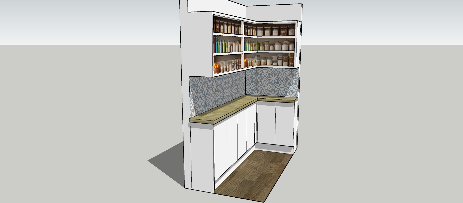

If you are after just plain open shelves, it is possible to build it out of plywood and melamine panels. These panels can be put together to give you more shelves which technically can be anchored to the studs inside the wall. The other option is to put in narrow cabinetry and combined with open shelves. I've placed a sample image below to give you an idea of what it could look like. The cabinets are based on the Kaboodle wall cabinets series which are 320mm deep and come in flat pack default sizes. The shelves at the top are custom built from Specrite 1800 x 600 x 18mm Timber Multi Use Pine Panel, this is something you'll need to build from scratch yourself or ask cabinet maker to do it for you. The addition of LED lights under the shelves will give the area a nice afterglow.
The only change that will need to be applied to your pantry is the modification of the door. It will need to open outward in either a single panel or in a split foldaway manner

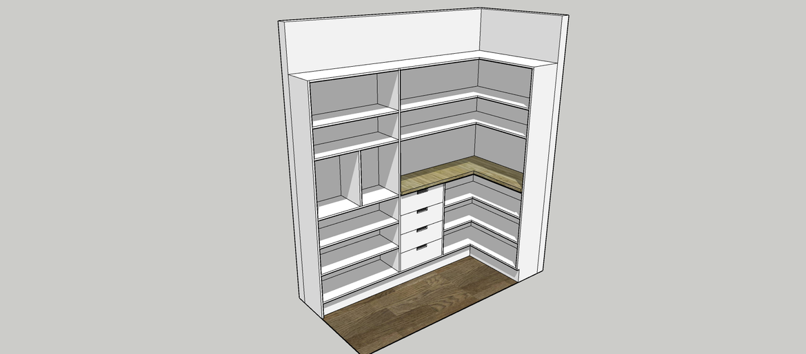

Generally speaking, its basically just open shelves that travel from one end to the other, smaller shelves can be incorporated in the build or custom designs that you would like to put in. Please give me some time to draw up a sample image. As soon as I finish, I'll post it here.
Re: Cupboard internals
Hello @SandieR
My apologies for the delay. Here is a sample layout of your pantry with open shelves.

Thank you, Eric, but I wasn't clear in my previous question. I don't really want a basic design drawing... I didn't understand what you previously meant by "If you are after just plain open shelves, it is possible to build it out of plywood and melamine panels. These panels can be put together to give you more shelves...".
What plywood? What panels? How would you fix them to each other and to the wall?
Thanks
Hello @SandieR
The materials I was referring to are the following:
These panels can all be cut down to size and assembled as shelves in whatever configuration you might want. They can be put together using standard Zenith 10 - 8 x 75mm Galvanised Countersunk Rib Head Timber Screws - 50 Pack or similar. The shelf assembly can be anchored to your wall using Hafele 23 x 23mm Angle Bracket - 20 Pack. Some of the panels can be painted and stained while the melamine panels provide a tough durable surface straight away.
