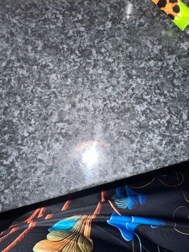

hi i have a black kitchen bench top. can i get ply or mdf, nail glue it down and stain it? Will it work? I want to stain it walnut

Also for your third point. It is stone and not laminate under so how would that screw or glued on timber ?

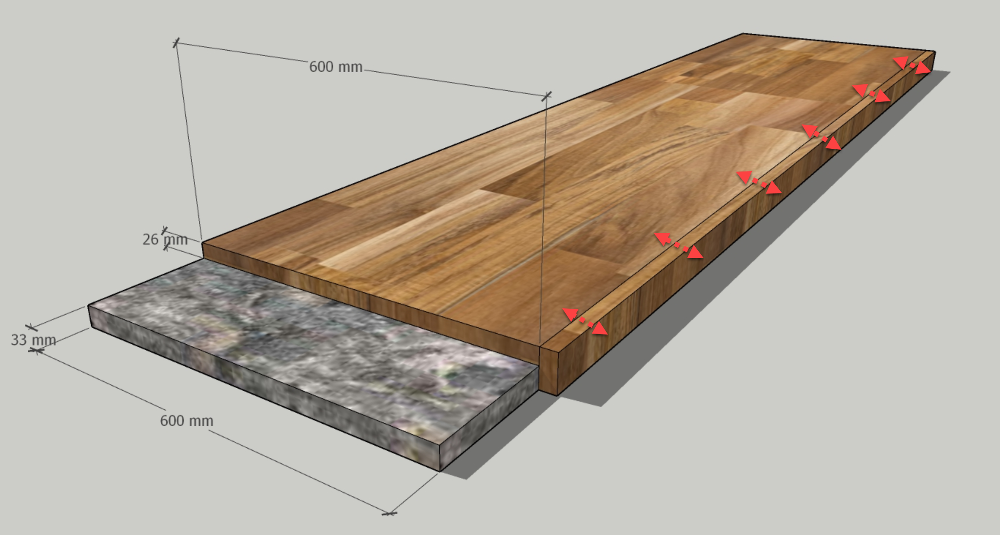

1. Yes, this is the small piece along the front. It is not 100% necessary, but it will give you a much cleaner finish that conceals the existing benchtop and makes the timber appear to be one solid piece.
2. The benchtop joiners Eric was referring to would be something like a dowel or biscuit joiner roughly every 300mm along the edge of the benchtop in the locations of the arrows below.
3. If you couldn't screw up through the existing benchtop, you would have to glue the benchtop down with a suitable adhesive for the existing benchtop. In the case of a stone benchtop, this Sikaflex®-118 Extreme Grab Construction Adhesive would be suitable.
Ultimately, the best option is to replace the benchtop, but if you couldn't do this for whatever reason, this would be a way of updating the look without removing the benchtop.
