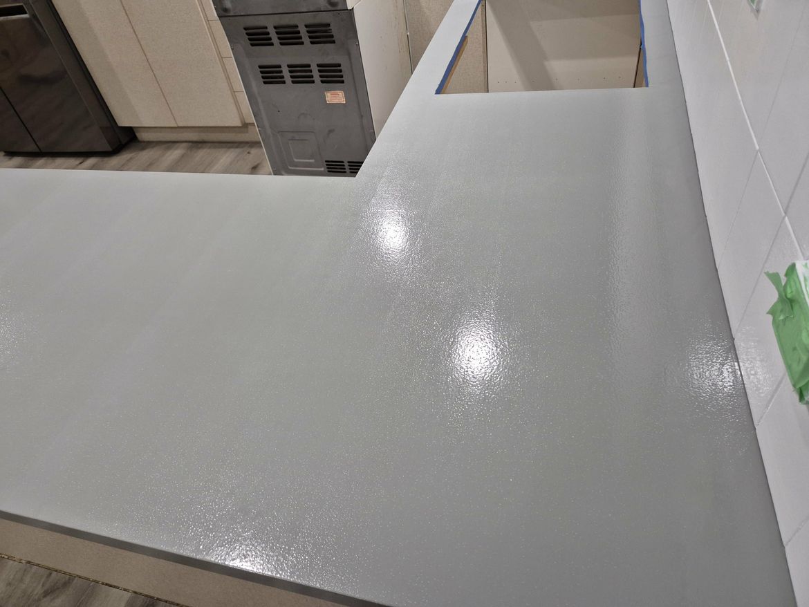

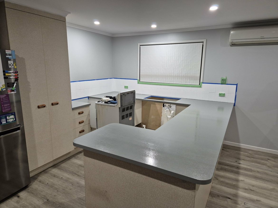

Terrible finish on the primer coat.
Very 'orange peel' like effect. We are very disappointed with this result, but I am concerned it is a prep issue.
For most of the benchtop and splashback tiles: we cleaned thoroughly with sugar soap, and gave a quick sand with 400 grit orbital sander. Wiped down with wet cloth after wards, twice.
This benchtop is 30 years old, has some surface wear and could be some pretty baked-in grime.
We have also patched a hole in the benchtop left from the old sink (new sink is smaller), this involved a new sheet of melamine covered chipboard.

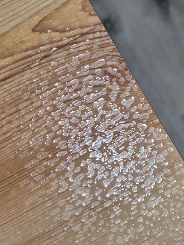

The paint on the new melamine turned out fine, anywhere I had to sand the old benchtop quite heavily when making this repair also seems fine.
Is this a prep issue? Do I need to heavily sand the whole benchtop, and tiles?

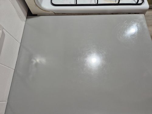

The paint seems worst near the stove, suggesting to me that oil or other contaminants in the laminate are the culprit?

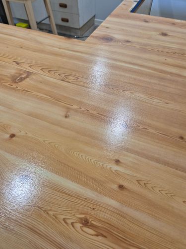

First pic: overall finish
Second pic: near stove
Third pic: new melamine covered chipboard

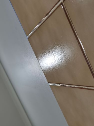

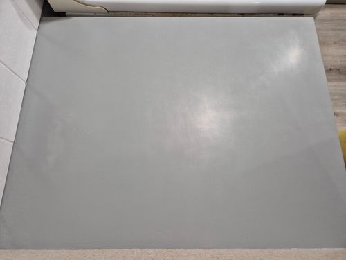

Fourth pic: splashback tiles

Re: Dulux kitchen renovation range issues
Dried pics
Going to try sanding it back with 180 until wood grain texture is gone, polish up with 400, and repaint.
Might get some orbital swirls, if tactile will probably try smoothing further.

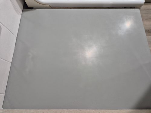

Sanding back took a while, but the primer went on ok.
No major issues with the colour coat, but the clear coat went terribly.
Initial issue was working the paint too much, seems you have less than half as much time to rework compared to the colour coat otherwise the roller lifts the coat and it becomes very rough.
Had to sand that back - we did score a free second tub of paint since the instructions are wrong on the tin AND on the Dulux site, and there is another post on this forum from someone at bunnings specifying better instructions, and when i called the Dulux help line they said basically the same thing. This seems to be a known issue so probably worth communicating better.
Second clear coat when on and didn't have the issue of roller marks, got a new issue though - lots of bubbles.
In an effort to avoid reworking the paint we were using more of it, the latest diagnosis from Dulux is that we used too much paint which allowed the bubbles to form when laying the paint, even when using minimum re-working (though any late reworking made EVEN MORE bubbles). This we have not been able to confirm since we were done painting before they opened again on monday.
It seems to me that with the correct instructions, which are actually quite simple, you could more reliably get an even coat with a clear finish - why the Dulux video dumbs things down so much that you are basically guaranteed to get a bad result is so deceptive it is grounds for a full refund frankly.
It's so bad that I had to coerce my wife into even letting me sand between coats to knock the bumps and bubbles back, because the instructions didn't mention any sanding which implies you should NOT sand.
Unfortunately my wife is 38 weeks pregnant, we did not have time to wait days for a Dulux response (closed over weekend) and most paint section employees (tried two bunnings on both days) had very little knowledge of the product, or painting in general seemingly since no-one knew why we were getting bubbles (too much paint according to dulux). We have had to forge ahead with our bubbly mess.
The bench is now drying, and i will need to attempt to sand and polish it after the fact to an acceptable finish due to the issues we had, this will take at least 8 hours, probably more.

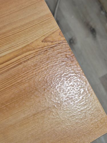

Below: First clear coat - rough from going back to roll paint that had begun to cure, suspect this happens in less than 60 seconds, maybe less than 30.

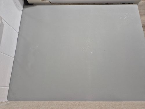

In order to salvage our result, I will be attempting a polish of the clear coat using sandpaper, and possibly automotive cutting and polishing compounds, though I was hoping to avoid that.
Bunnings does not sell this sort of thing, so I would be going to supercheap or something.
For anyone else thinking of doing the same, the plan is:
1. Hand WET sand with sanding block or 'large hand sander' to start with - 400 or 600 grit
- Note: waiting a minimum of 24 hrs for wet sanding is required - i will be waiting 2 or 3 days to allow a better cure before beginning the finishing process (can't install the sink until after 7 days anyway)
- Idea is to flatten out the top coat, removing high points and bubbles until we get to the main surface of the coating where some inevitable orange peeling will have occurred.
- Using pretty fine sandpaper to minimise chances of creating scratches that are too deep to reasonably resolve with finer grits later.
2. Continue WET sanding with finer grit - moving to 800 and 1200
- May switch to sanding without a block depending on results, so the the whole surface can be sanded rather than just the high points (do not want to risk sanding the whole top flat and cutting through the clear coat to the colour coat)
3. Clean and assess
- If it looks to be good, keep going to finer paper until an acceptable finish is achieved or no improvements are being made
- Have 2000 and 3000 paper to move to if it helps
4. Polish with some kind of cutting or polishing compound (note: not food safe? don't put meat on your counter tops though)
- if the finish is not good enough after 3000 sanding, find and use some kind of buffing compound, probably 3m or some kind of automotive liquid polish.
- Will probably use a buffing machine
All of these steps will be performed on a smaller bench section that is separate to the rest of the bench to test results before we start on the main section.
Will try to remember to post results.

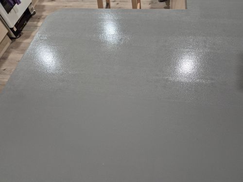

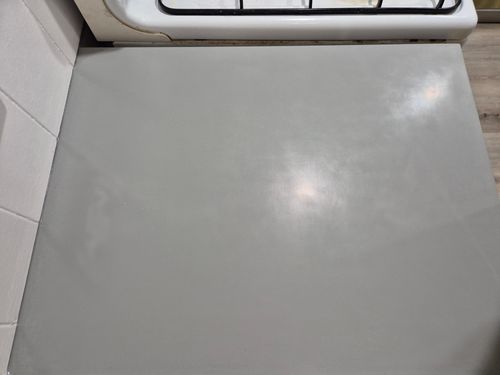

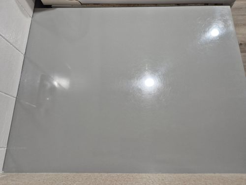

Finished polishing, it is a significant improvement but not perfect due to the suboptimal paint application with not enough sanding between coats.
Wet Sanding Process:
Sand with 400 until surface is even  or close to what you want, use a sanding block or hand sander.
If there are significant low or high points use your hand instead of a block or you will sand through the clear coat trying to get it flat.
Use enough water for the paper to glide easily; if it catches or gets suctioned to the surface, use more water.
Next sand with 600 or 800 until it no longer feels rough, indicating the scratches from 400 are gone. Do not sand too much.
Keep stepping up the grit, sanding until it feels smooth with that grit.
Use circular motion and light pressure.
Go from 600 to 800 if you used 600, then go to 1200, 2000, finally 3000.
After 2000 you should be very careful what you wipe off the water with, paper towel can cause light scratches, use microfibre cloth.
Do a final sand with 3000 with very light touch and circular motion.
Now we can move to polishing.
I used Turtle Polishing Compound and a hand held foam applicator from Supercheap.
Dampen the applicator, get some compound, and start a small section (30x30 cm or so).
Apply decent pressure, but not enough to overly deform the foam applicator.
Circular motion is good, but you can also go in straight lines, alternating periodically to go perpendicular to the last direction.
As the compound starts to dry, ease off the pressure and use a light touch over all covered areas to finish.
Get a wet cloth to carefully wipe the area clean, dry with clean microfibre cloth
Repeat as needed.
I got a high gloss with this approach, but there are some surface irregularities due to the poor roller technique which cannot be polished away.
I would suggest that if people are struggling with the rollers, you suggest they switch to large brushes instead and polish the result. Where we used brushes to cut in there were no bubbles, so the sanding and polishing process produced a flawless result.
It would also probably be less work to sand flat.
Photos in the next post.

 Approximately how it started
After 600 grit
After 800
After 1200
After 2000
After 3000
After polishing
After final polish
Bottom middle of bench, you can actually just about see my phone, taking the photo.
Here's a different angle showing what you would normally see when in the kitchen.
