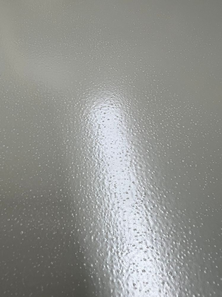

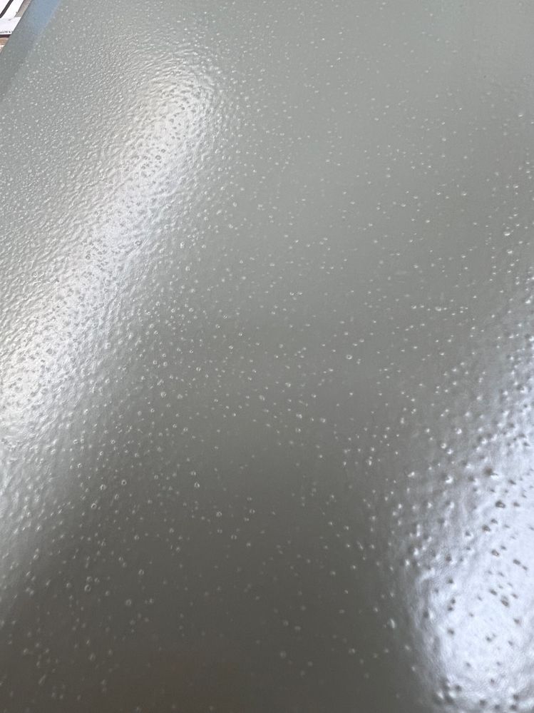

Hi, I have painted our kitchen cabinets in the Dulux renovation range and used the renovation range clear coat in satin on half the cabinets which came up fantastic, but... about 4 days after opening the tin I was ready to complete the clear coating on the remainder of the cabinet fronts and the finish has come out really bad, like lots of bubbles bad, I am really confused as I used a new roller and followed the instructions on mixing like the first time I used it, only thing I can think of is that maybe the mixture is starting to "go off", it does say on the tin that it is good for up to 10 days. Has anyone else had this issue, or local Dulux supplier is still to get back to me but thought I would try here and see if there is an alternative clear coat I can use, one that doesn't go off quickly or one that isn't a 2 pot mix.

Bubbles in a clear coat can happen for a few reasons, but since your first half went on perfectly, many of the usual causes are unlikely. Typically, this type of bubbling occurs if a foam roller is used, which can aerate the surface, if the can has been shaken instead of just stirred (introducing air into the mixture), if the product is overworked during application, or if environmental conditions have affected the coat. It’s also possible, though unlikely, that something happened with the mixed product in the four days since opening.
From the description and your photos, it does seem like air has been introduced into the formula somehow. The Dulux team has your docket and will be reaching out soon to discuss the issue and the best way forward. At this stage, I wouldn’t recommend switching to another brand’s clear coat on the same surface, as this can create compatibility problems. The likely solution will be to sand back the surface to remove the bubbles that are standing proud and then recoat. After that, reapplying another coat of the same product, but potentially a new can, is probably the safest approach.
Please bear with us as Dulux will be in touch shortly to help investigate whether there’s a batch issue or something else has affected the can, and to guide you through fixing the surface. Just to be sure, if you haven't logged the problem with the Dulux technical team directly, please do so on Ph: 13 25 25 as they are keen to assist.
