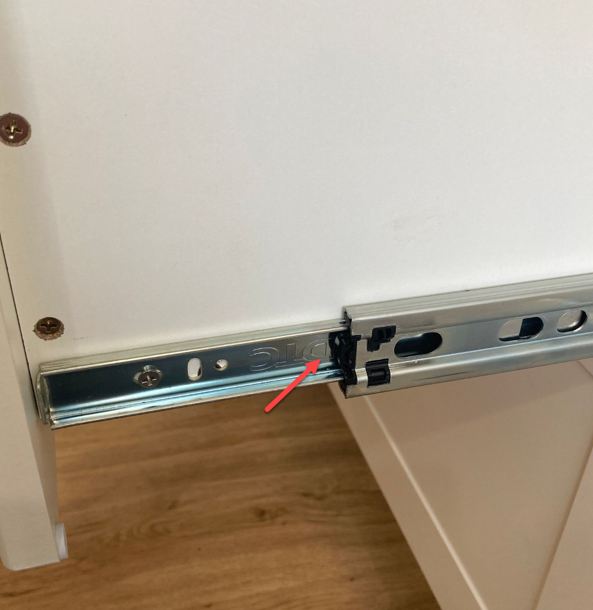

There is usually a little black lever at the end of this part of the runner here -
If you fully extend the drawers, then flick this lever up, you should be able to pull the drawer out.

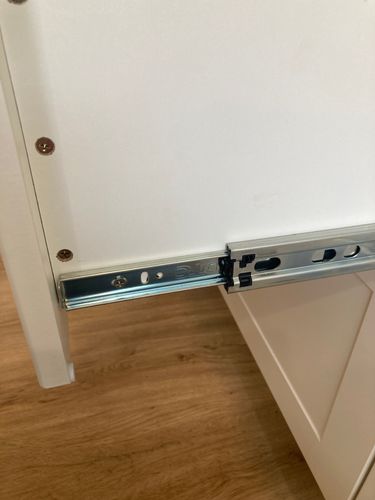

Thanks for replying Jacob. I can see the black lever but it is not accessible when I pull the drawer out
it’s in the 3rd hole back

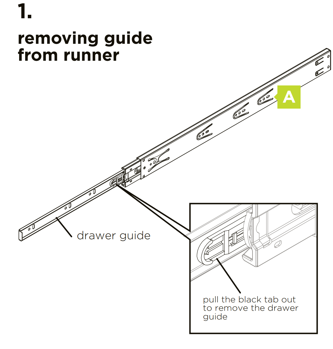

Alternatively, does that little black tab at the end of the runner come out like described in the example from the Kaboodle Soft Close Drawer Runners guide?
Give this a try and let me know how you go.

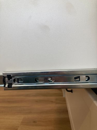

Thank you Jacob. The black tab on the end does not pull out unfortunately. I have wiggled things with the screw driver and I have got the black lever out on the left side and a little further forward on the right. But I cannot get the lever on the right hand side to come out. This must be part of the problem as when I look at my other drawers both levers are out
Hi @ksmith1,
I'd say there's a good chance this is why things are getting stuck.
Perhaps something flexible, like a pipe cleaner or a piece of wire or even a paperclip could help get into the tighter spot behind the runner and push it out.
Persistence is key, there should be a way to get it out.
