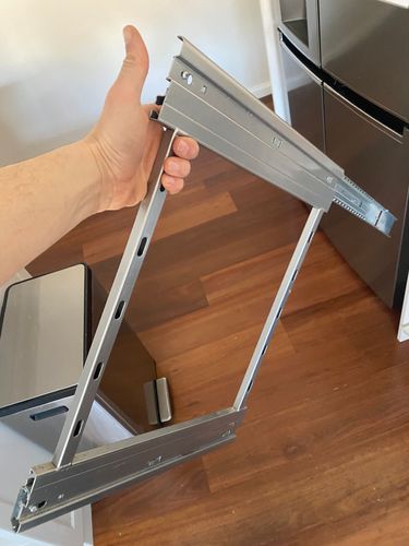

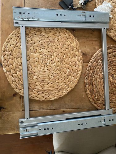

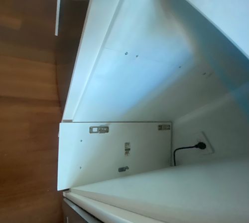

I have 2-Tier Slide-Out Under Sink Unit (I think it is a Practa Solutions 200 mm )  that was previously installed but has recently come off. I’m not sure how to correctly re-install it back to side fix panel.
Could you please provide the installation manual or instructions for this product so I can fix it properly

To reinstall the unit, start by sliding out the secondary runners — these are the arms that the wire baskets attach to. The solid frame with the wider part of the slider is what fixes to the cabinet wall. You have one already extended in your second image. This allows access to the mounting holes in the other part of the runner.
Hold the frame against the side panel of your cabinet and line up the holes in the frame with those on the cabinet. If the original screw holes are stripped, you can offset the frame slightly and make new pilot holes so the screws bite into fresh material. Use cabinetry or chipboard screws that are short enough not to go through the cabinet wall.
Once secured, you can reattach the baskets and front panel to the extended runners, and it should operate smoothly again. If you have issues we can try to track down some instructions for you.
