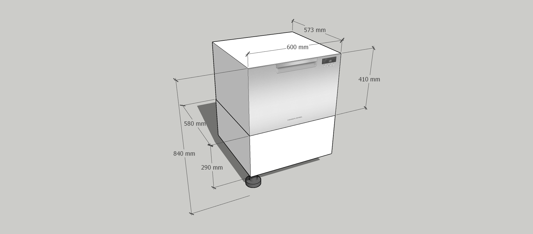

Hello @karinas
I suggest installing a Kaboodle 600mm 1 Drawer Base Cabinet. It's very close to the measurements that you need to fit your single dish drawer. Should you need more space for height the cabinet legs are adjustable and can be lowered down to what you need. I've placed an image below to give you a better idea of how they can be put together. Please note that the cabinet depth is 580mm with the door attached.
