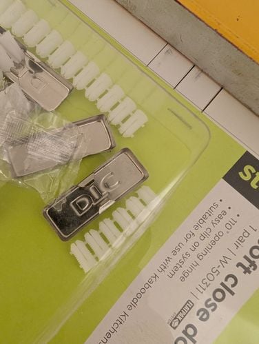

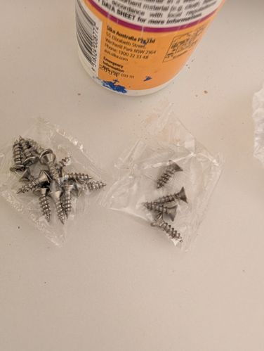

Should I just be drilling a small pilot hole and using the self tapping screw provided or should I be drilling a bigger hole to accommodate the plastic lugs they provide, driving a lug in and screwing into that?

Before drilling, please make sure that you have enough plastic plugs to cover the number of screws that you have. I propose using the plastic plugs as this is the provided method of fixing the hinges to the cabinetry. This means that it has been tested and this type of fixing will provide a solid anchor for the hinges.

Thanks Eric,  should I be taking the plate back off or just drilling through using the plate as a guide.  I noticed the hole in the plate is a mm or so smaller than the pre drilled holes with the lug.

I've spoken with Kaboodle, and you do not need to lugs on the front two holes. Pre-drill through the plate and screw into the timber. The hinges are already well secured with the rear screws and lugs, and the front screws are just an extra precaution.
