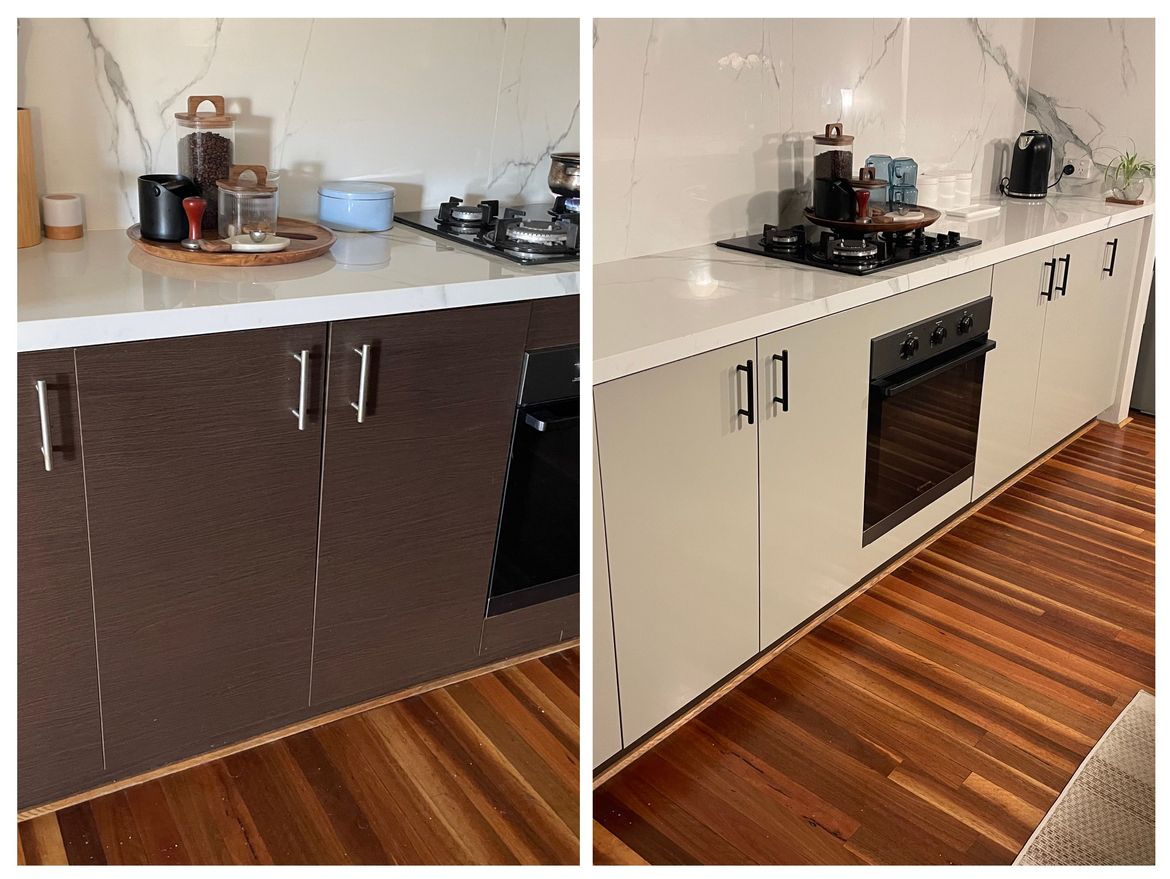

Recent kitchen cabinet revamp.  Built the house in 2010 and these were the original laminate doors.  Repainted and added
soft close hinges.  Resprayed the original handles and all up cost less than $200!  Cheap refresh until a full reno is needed.pretty happy with the result.  Not perfect but brighter and feels fresh.

Re: Kitchen cabinet paint revamp
Hi @Beginner20,
I used the Dulux Renovation cabinet paint and an enamel spray for the cabinet handles.  I spent quite some time preparing the doors ensuring these were clean dust free and then applied the paint with a mini roller in a high density foam to try and get to best smooth finish.  I applied the paint fairly thinly to minimise runs and drips.  The edges were a little fiddly but I had a set-up that I could leave for a few days and I just rotated the doors and painted various parts over a few days. Painting the cabinet trim was also fiddly and I used a fairly slim brush for that.
