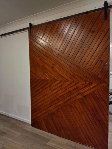

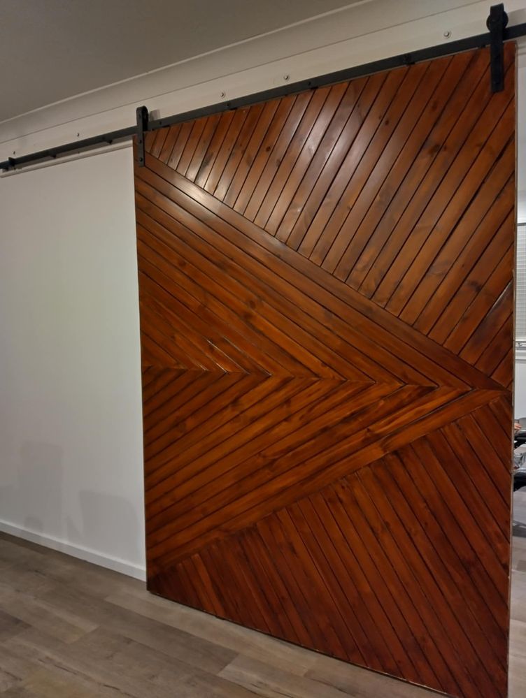

Feature barn door, Wife wanted a herringbone barn door to separate the kids retreat from the main living and dining area.
The design phase went as follows:
Rolltrak Black Matte Barn Door Raised Handle - Bunnings Australia
https://www.bunnings.com.au/140-x-12mm-4-8m-unprimed-solid-321-lining-board_p0517521 - alot
2440 x 1220mm 18mm Plywood Hardwood Marine AA Grade - Bunnings Australia x2
42 x 19mm 2.4m DAR Pine Premium - Bunnings Australia
Timbermate 250g Pine Wood Filler - Bunnings AustraliaUNi-PRO 4 Piece Foam Brush Set - Bunnings Australia x4
sanding paper
small nails - did not have a nail gun
screws and lots of wood glue
Ryobi 18V ONE+ 165mm Circular Saw - Skin Only - Bunnings Australia
Craftright Metal Saw Horse - 2 Pack - Bunnings Australia
hammer
putty knife
orbital sander
Order and collect the materials - order the rails.
Purchase materials
Purchase materials
Create the Frame of the door - got these cuts to size at bunnings to reduce the work at home.
Flip and get the center of the arrow.
Finish the arrow.
Finish the rest of the design, trim all the hanging pieces, fill in the nail holes with wood putty and sand to 240.
Flip and complete the easy side, fill and sand again.
Complete the 1st stain - 3 in total (hand to sand back to wood due to some unevenness with the stain.
Door complete, the order side has a handle.
